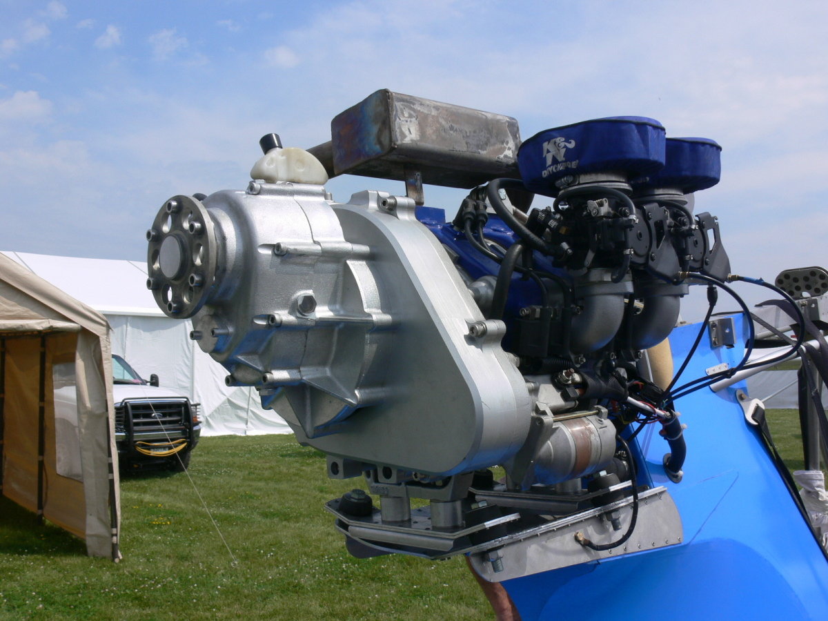

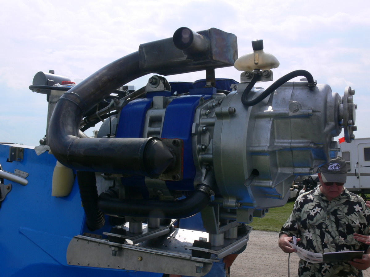

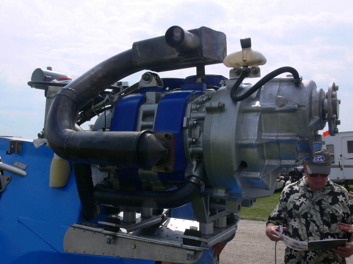

The Hornet guys got a few hours flying the 2 rotor Rotamax powered
airplane before departing to OSH. Unfortunately I did not get a video
yet. The muffler is half a spin tech and it is rather quiet.
The rubber gear box coupling was replaced with a 50 durometer version
down from the original 60 durometer version with a noticeable reduction
in idle speed. 50 durometer is the lowest available for that brand
of coupling. Like all geared 2 rotor aircraft engines they tend to
resonate around 1800 RPM. The quick and simple cooling system
worked great despite being installed BEHIND the cargo pad Smile
That is the president of Hornet (Robert) removing the gear box from the
engine.

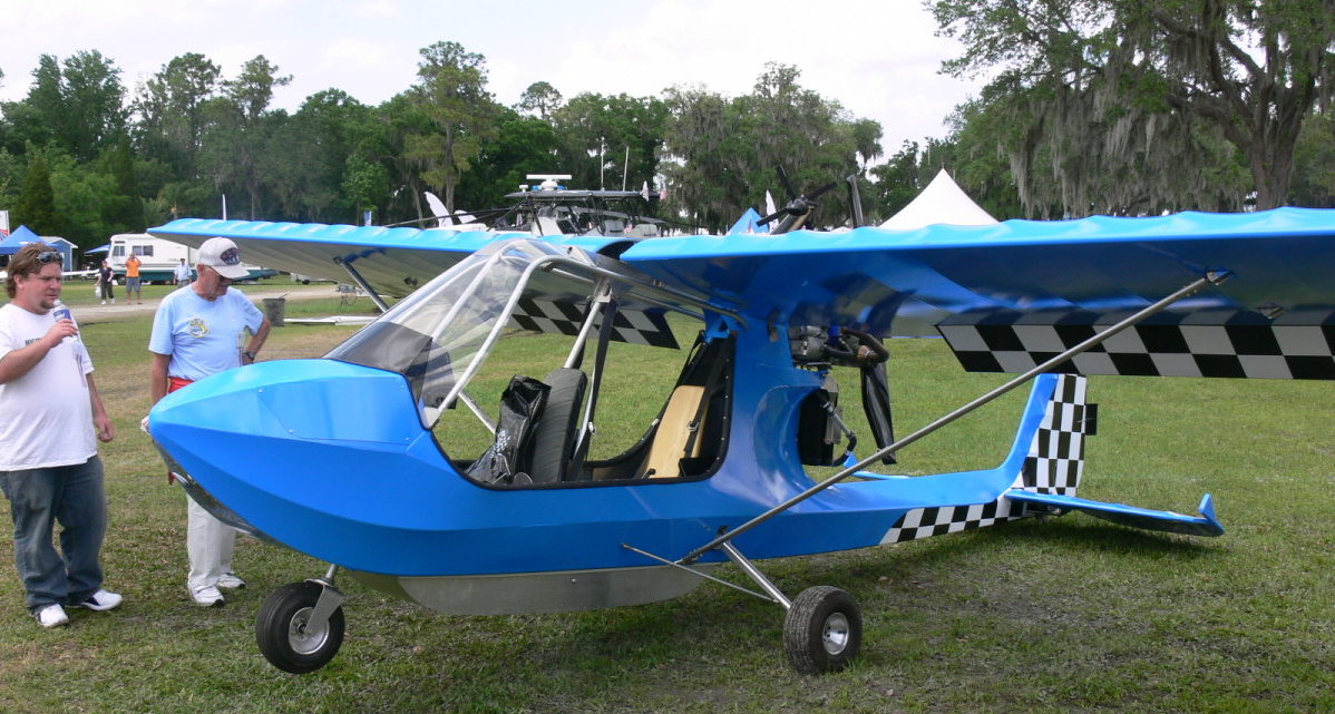

The Hornet is a cute little airplane. I can imagine having fun with
something like that. I am surprised it is using the RotaMax two
rotor--as that seems like a lot of engine for this aircraft. But I
am just guessing what its hp/weight requirements might be. So C how
did it perform? Two more observations: first C that narrow motor
mount will take some getting used to. I would not be comfortable with
it. And C secondly C how big is the fuel tank? I think the two rotor
will be thirsty. Jerry
