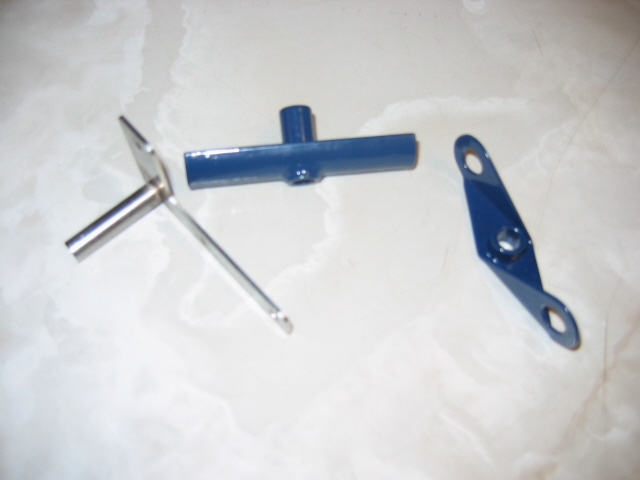

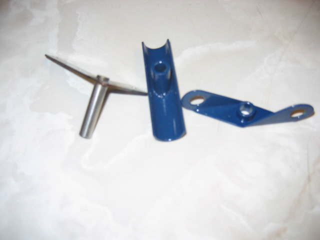

Well here I am back again C thanks to everyone who takes the time to answer the questions.
Once again I have parts that are not covered by my manual for my Kitfox 4.  In the manual
I have C it shows an older (I think) style door handle and that does me no good.  I'll attach a
 couple of pics of the parts I have C I know if I see a picture of them in action it will all be clear C
but right now I can't figure how they go togeather.  Thanks again for all  the help.  Jim Chuk   Kitfox 4  MN

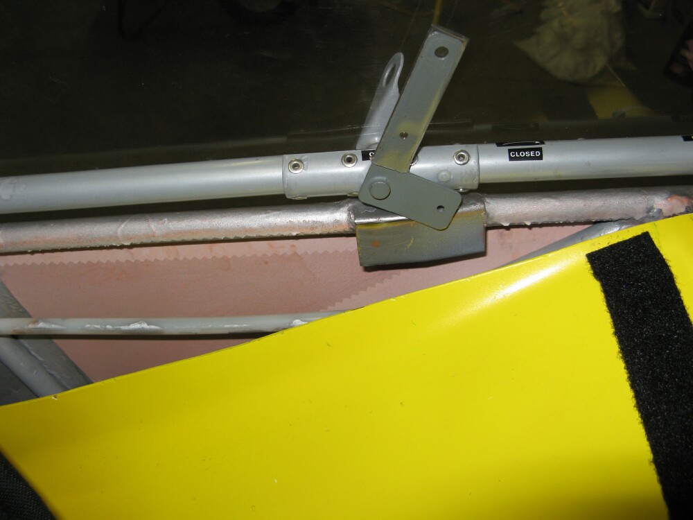

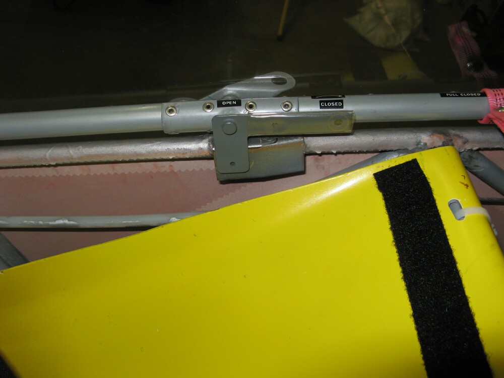

I just happen to have a couple door handle pictures handy. The instructions say to install it half way between the front of the seat and the front door post. You can see mine is installed at the center of the door. A little difficult to open in a hurry if someone isn't familiar with my Kitfox, but holds both front and rear of the door closed tight.
Also note the "Striker plate that is epoxied to the fuselage tube.

Thanks Tom for the pictures C all clear now.  With the 3 countersunk holes in the inside part of the door handle C  it looked to me like it must be rivited to something C Why else would the holes be there??  Just to confuse me I guess.  Thanks to all again C I'll check out Merle's also  Thanks again C  Jim Chuk  Kitfox 4  Mn

With the 3 countersunk holes in the inside part of the door handle C� it looked to me like it must be rivited to something C Why else would the holes be there??
Jim, the large hole is to attach a round knob. The two small holes the instructions say to match drill through into the "Saddle" where you install the plastic "Detent rivet". I didn't do any of that.
One important note is the instructions emphasize to epoxy the striker plate on to the fuselage tubing. Do not drill and rivet for structural reasons.

PostPosted: Fri Aug 01, 2008 9:17 am    Post subject: door handle questions Reply with quote
The detent rivets help hold the handle in position when opened, and
also when closed. The plastic rivet heads wear out after a
while...mine did...but if you are careful to not let the door bang
shut with the inside handle lowered so as to hit the fabric, you
shouldn't have a problem.
