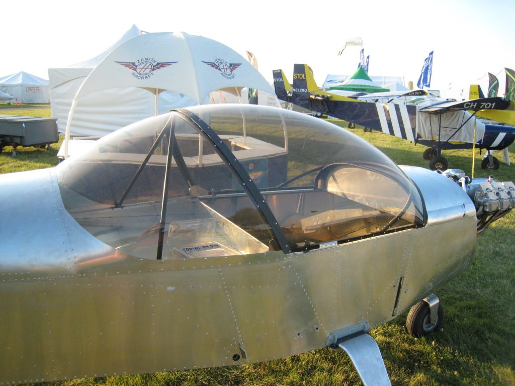

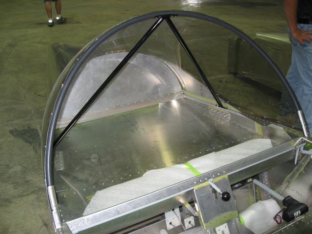

A question for anybody that has eye balled the 650XL. Did any one happen to note how the diagonal members of the roll over structure are attached to the airframe? Do they appear to fasten to the lower longerons? The arched shaped tubing looks like it's fastened to the upper longerons.
Bob Dingley
601XL
Looking for a car that's sporty, fun and fits in your budget? Read reviews on AOL Autos.
(http://autos.aol.com/cars-BMW-128-2008/expert-review?ncid=aolaut00050000000017 ) [quote][b]
Afterfxllc(at)aol.com
PostPosted: Tue Aug 05, 2008 3:33 pm    Post subject: 601XL Support Reply with quote
It is attached to the upper longerons about mid way in the baggage compartment.
Jeff
craig(at)craigandjean.com
PostPosted: Tue Aug 05, 2008 3:44 pm    Post subject: 601XL Support Reply with quote
The attached photos show some details (one from AMD, one from Oshkosh). The V tubes terminate at the upper longerons.
The hoop is still aluminum and rests on the upper longeron. The steel V supports the hoop at its top with a U-shaped saddle.
