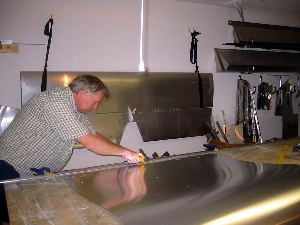

PostPosted: Sat Jul 19, 2008 9:38 pm    Post subject: Re: cutting long cuts of aluminum Reply with quote
I'll agree with the other posters. The Olfa P800 is a great tool. I got mine here:
http://olfablades.stores.yahoo.net/5012.html
Attached are a couple of photos to illustrate its use.
If you haven't done so, I strongly recommend the Scratchbuilding Basics DVD from homebuilthelp.com. Mark and Dave demonstrate the Olfa knife technique along with lots of other great building tips.

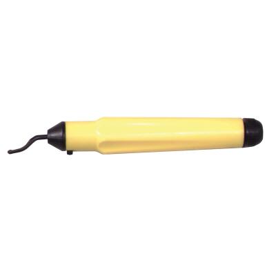

craig(at)craigandjean.com
PostPosted: Sun Jul 20, 2008 6:19 pm    Post subject: cutting long cuts of aluminum Reply with quote
I find that you have to enter your zip code before the Home Depot site will let you do anything.
Anyway I’ve attached a picture of SKU# 639272. Other vendors carry it too. It’s the one with the hollow yellow handle and the dog-leg tip where the different size tips store in the handle. Here is a link to what looks like the same tool on the Avery site:
http://www.averytools.com/pc-74-43-royal-multi-burr-tool.aspx

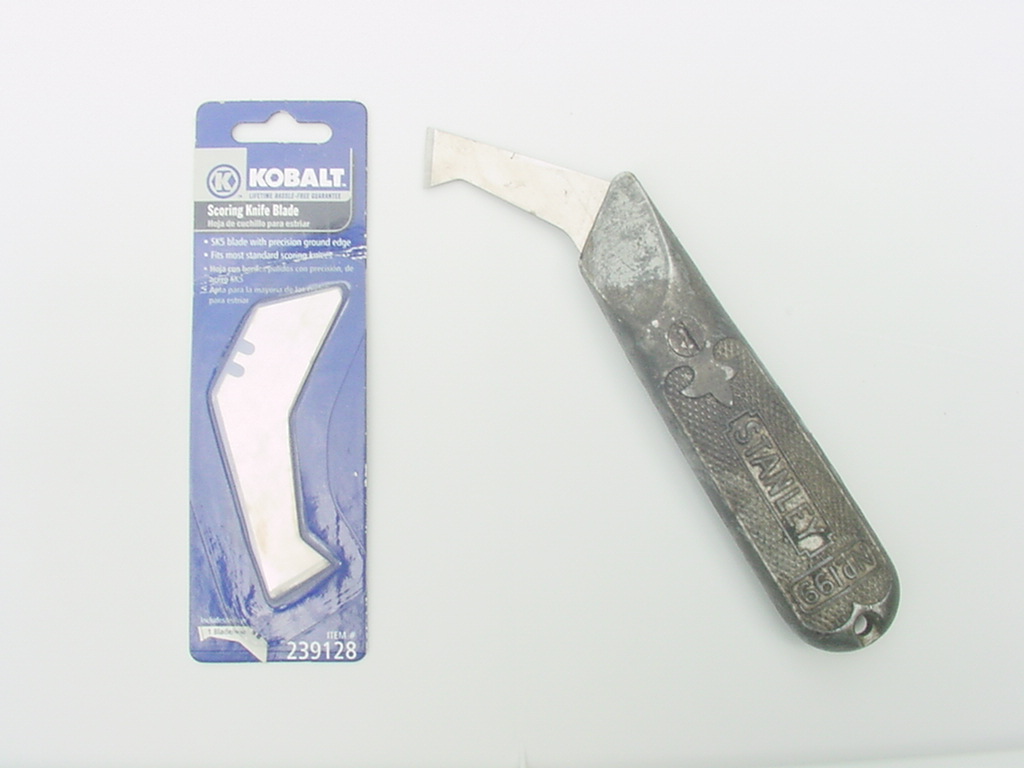

PostPosted: Mon Jul 21, 2008 4:32 am    Post subject: Re: cutting long cuts of aluminum Reply with quote
I never found the above mentioned Olfa knife at my local Home Depot of Lowe's stores and was too cheap to pay shipping equivalent to or greater than the purchase price of the knife. I used a regular old utility knife with great success for many long cuts. As mentioned, the key is to clamp a straight edge on the side you want to keep. That way if your knife wanders, it wanders into the cut-off side.

PostPosted: Mon Jul 21, 2008 8:37 am    Post subject: cutting long cuts of aluminum Reply with quote
Hi David,
About a year ago I found a scoring blade at Lowe's that fits into my old Stanley blade holder (picture attached). I'm not sure if it works as well as the fabled Olfa knife, but it works fine for me. Looking forward to seeing some of you next week.
Cheers,

naumuk(at)alltel.net
PostPosted: Mon Jul 21, 2008 4:00 pm    Post subject: cutting long cuts of aluminum Reply with quote
Bill-
That looks like it would work.
