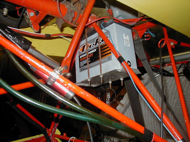

When I went to change out an old battery on the FireFly, I ran into some
problems. I decided to try and come up with something simpler and lighter.
On my second attempt I came up with the following:
http://www.thirdshift.com/jack/firefly/firefly142.html
Ended up saving a little over a half a pound, and so I recovered my added
weight for strengthening the landing gear.
Flew the first time in a month today. It was just great. If I am lucky, I
will fly tomorrow morning to my EAA Chapter 373 meeting in Hagarstown.
Jack B. Hart FF004

Jack,
That looks like a good solution.
I have a suggestion based on a problem we encountered on our Allegro. We used a couple SS clamps similar to those shown in your photo, to help stabilize the muffler which had a tendency to vibrate a lot and crack. Inadvertently, we had one of the clamps making a relatively sharp bend (like your 90 degree bend at the bottom of your battery) where the screw thread slits were located. With the higher stresses at the corner and the weaker part of the clamp, it broke. When we installed the replacement we positioned it so that the weak part was not at the higher stress area and had no problems since then.

NICE job on the new battery holder. Did you have to recalculate any
W&B figures? Looks like too little to affect anything.

I used two saddles from 2" exhaust clamps and made long 5/32 U bolts.

Thom,
I purchased some new clamps and repositioned the bends so that no slot was
over a corner.
