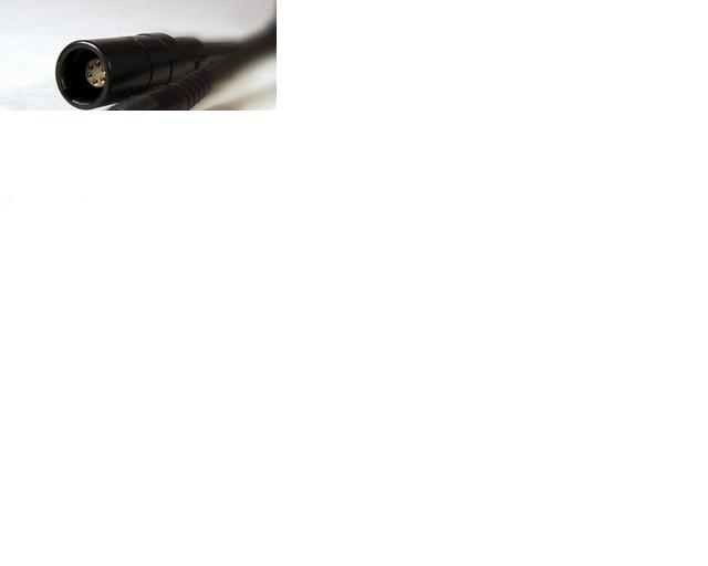

Since I was planning to use Bose headsets in the RV-10 , I had already decided that I would NOT install the standard RCA earphone/mic audio jacks. Instead I plan to ONLY install the Bose (LEMO) jacks with provision for earphone/mic audio and power for ANR. That decision is even more reinforced now that Lightspeed is now offering their Zulu headset with the LEMO connector. If I ever have to use a standard headset, I carry a RCA earphone/mic audio jack to LEMO adapter.
The only thing I cannot determine is if the Lightspeed LEMO is the same as the BOSE LEMO. I can't find any details on the Lightspeed LEMO and I found one reference that states it is a 5 Pin LEMO where I know the Bose LEMO is a 6 pin. It would be a shame if Lightspeed used a different form factor than the 6 pin LEMO that is used by Bose.

http://www.lightspeedaviation.com/content.cfm/Knowledge-Base/FAQ
Is Zulu available in an aircraft powered version to eliminate the need for
AA batteries?
Yes. The Zulu: P is the aircraft powered version. It uses the most common
aircraft powered ANR headset plug, the 6-pin LEMO. This plug is standard on
all Cirrus and Cessna 350, and 400 series aircraft. Should you need it, the
mating half of the connector is available from many pilot supply retail
stores.
It still doesn't answer your question, but it does appear like there may be
some hope that they are compatible
Bob

Well I guess like all things "it depends!" To use your analogy, If you are a VFR pilot and only fly VFR, the need for steam gauge backup is kind of redundant as looking out the window should be your backup. Same thing with jacks, are you worried about the jacks failing or that you may bring the wrong headsets?
All the same signals are in the LEMO jacks, only in a different form factor. I'm looking at a source for the male LEMO jacks and will make a few female RCA to male LEMO adapters. Should be able to put these together for a LOT less than the $100-$135 that Bose is asking--stay tuned. But then thier adapter includes a battery case for power. If you just want to get RCA signal to LEMO signal, its just wires.
William

Just to clarify, since I will only have the LEMO jacks, I would only need the RCA (female) to LEMO (male) adapter if I wanted to use a headset with regular RCA plugs-this requires no power.
If I want to use the Bose headsets with LEMO jacks in another aircraft without LEMO jacks, there are two options;
1) You can easily make an adapter by purchasing the $30 installation kit from spruce, adding RCA plugs and wire the power leads into a cigarette lighter adapter or battery pack.
2) You can purchase the Bose LEMO to RCA adapter with battery pack for about $100-$135.
Installing only the LIMO jacks actually simplifies wiring. I've seen folks totally mess up their intercom wiring and introduce ground loops when tying the RCA jacks to the LEMO in the panel.
