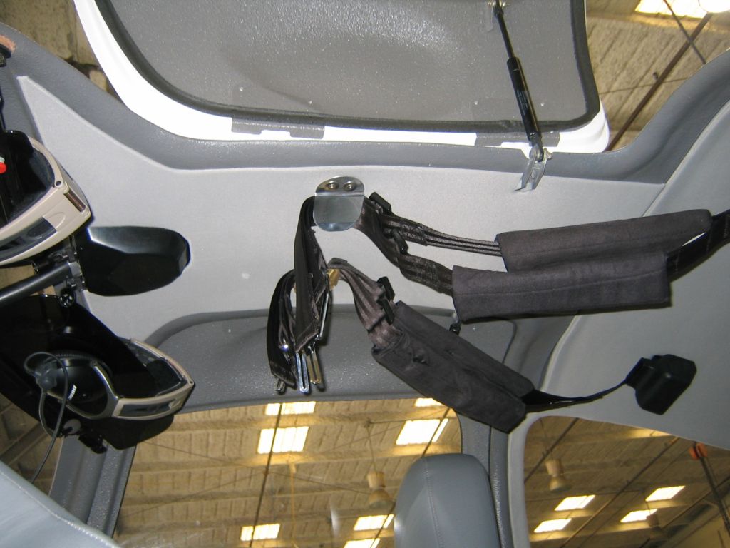

I didn't sand the aft section at all, except maybe a cursory swipe with 80G
to get the big chunks off.
The forward part between the doors took a bit of grinding to get it smooth,
maybe 10 gauge wire by your scale. Then, a piece of flat lexan went over
that area and was subsequently covered with headliner material. That
covered up a lot of unevenness.
