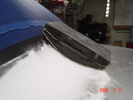

Jay – I used all sorts of stuff for sanding forms at different points around the fairing on my RV-7– scrap wood blocks, chunks of PVC pipe, a coffee can, a bucket, whatever fit approximated the desired curve at a particular point.. One of the most useful was a 3M hard rubber sanding block with the paper mounted on the “wrong” side.
neal

Neals' "wrong side" block idea looks really good!
Deems suggested a block called Dura-Block available at the auto paint stores. It's about 1.25" in diameter and 11" long made of a hard EVA rubber foam. It's just flexible enough and it works like a charm. It gets wrapped with a whole sheet of sandpaper. I use it by moving at an angle to the direction of motion for a few strokes, then for the same number of strokes angled the other way. I use a 45 degree or so angle for rough work, and a shallower angle for fine work, depending on the curvature.
