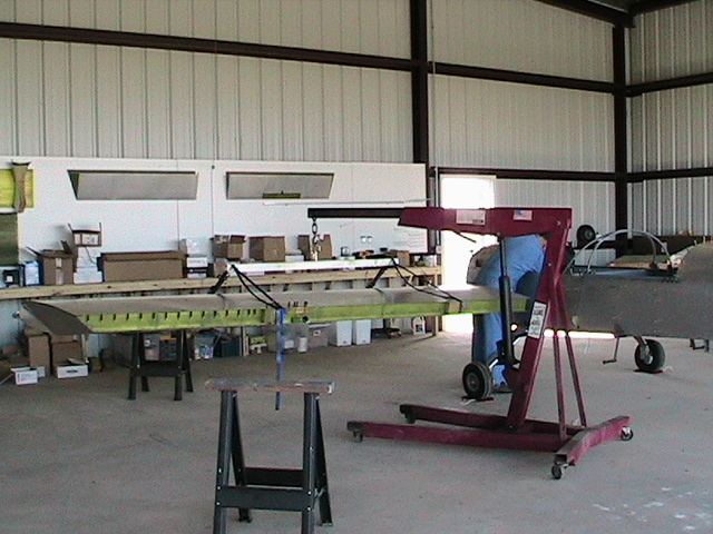

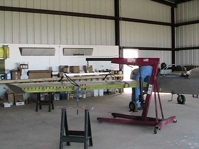

PostPosted: Fri Jul 11, 2008 9:26 am    Post subject: XL wing installation Reply with quote
Craig,
The attached photo shows how I did it. I had another guy helping, but with this setup, I could have done it alone.
I trimmed the wing skins to the cut line from the drawings. As I recall, the only extra trimming I had to do was on the bottom for the gear bracket.
I had the right amount of gap to install the rubber wing root gasket. Let me know if you have questions.
Jay in Dallas

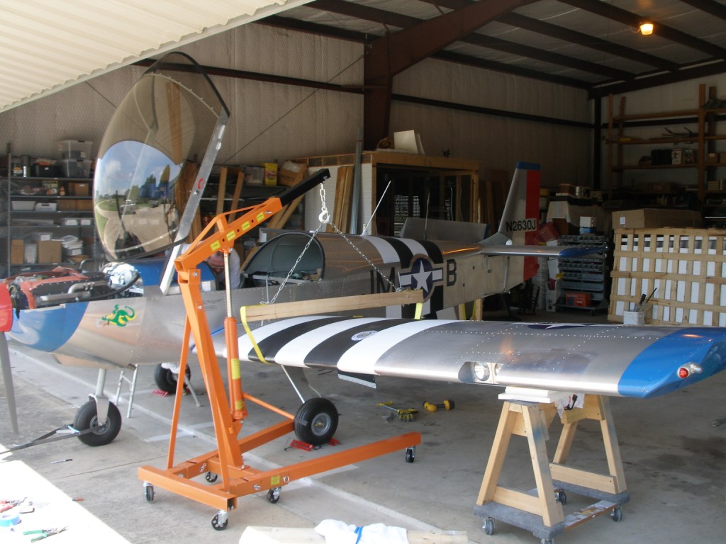

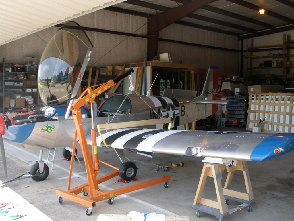

PostPosted: Sat Jul 12, 2008 2:44 am    Post subject: XL wing installation Reply with quote
I used an engine hoist which lifted a yoke made from 2" aluminum square tube that I had left over from wing and fuselage building. I had used the square tubes as supports while jigging and building those parts. I cut slots in both ends of the square tube to accept 1" ratchetcing web straps and drilled a 1/2" hole vertically in the center of the square tube for a lynch pin where the hook of the hoist attaches to it. I used 2 x 4 blocks at the wing's trailing edge and suspended the wing with the ailerons and flaps off. The hoist provides vertical adjustability and since it has roller casters, it can be moved with reasonable precision. You have to establish the right balance point span-wise for the web straps.
That being said, I trimmed a little at a time, many many times to creep up on the final cut.
Ed
601XL/Jabiru 3300
