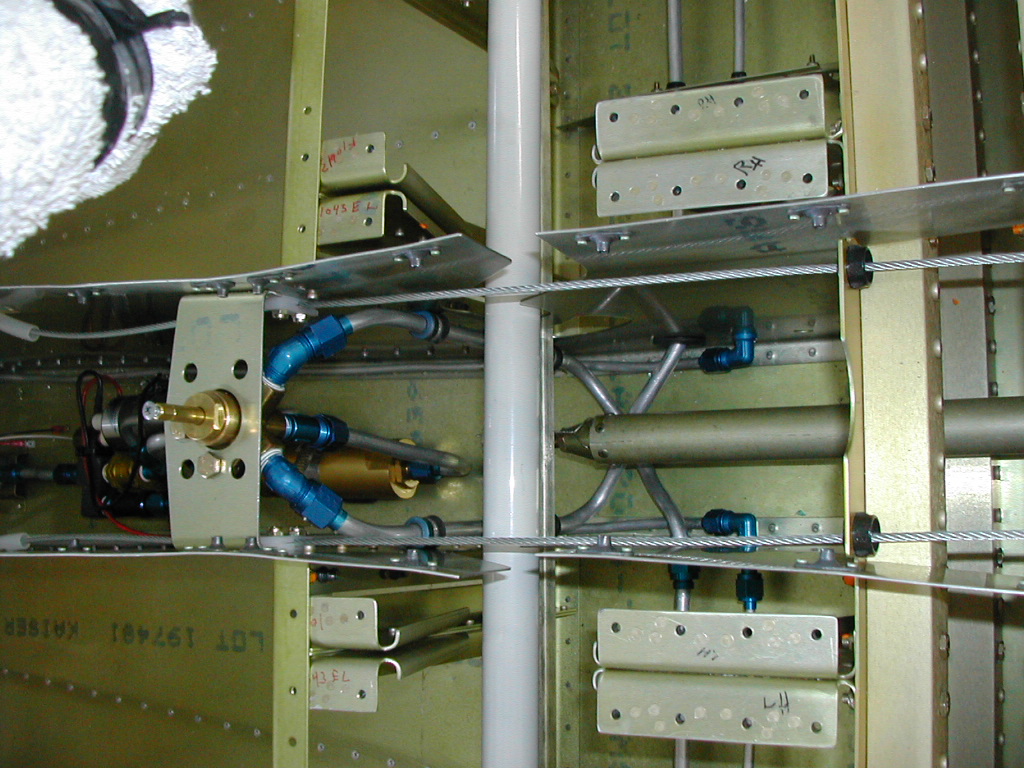

Here is a picture of Randy DeBauw's fuel vavle installed, it looks just
like the plans.
One question, if you were to remove and reinstal it upside down, would the
hole orientation be correct?
John

If you think about the position of the ports, it works either way. You
just plug a different port depending on the mount. Don't know why Van
changed the mount from the plans, you just have to scratch your head for a
minute.

Dave - I think you are right. After looking at the photo and the plans carefully, it seems that it doesn't matter. It will work in either orientation. The plug just needs to be on the other side (to block the unused port).
Flipping it upside down will get the correct orientation, but the bracket will sit about an inch lower, so that is ruled out. The Andair valve is really nice, but I am too cheap.
Bottom line - it will work as found. The only loss is a little more hair from head scratching.
