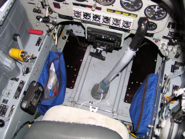

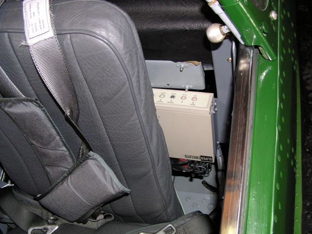

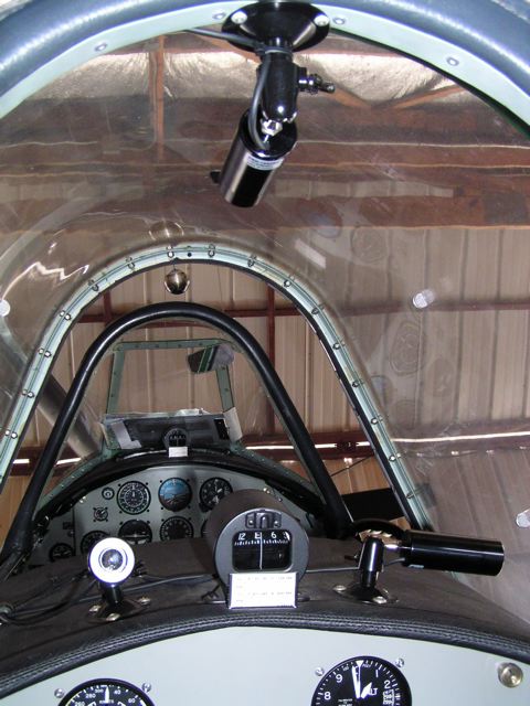

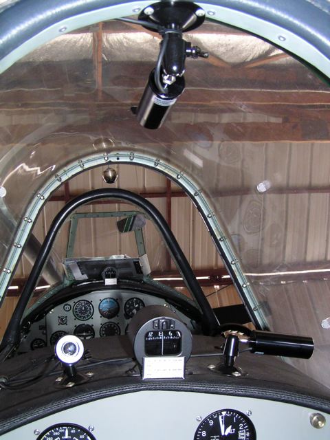

I would agree with Dave. I have a 4 camera system in my TW - I would not use it for taxiing. About $1000 worth of hardware. and 2 days of install. 4 sony lipstick cameras feeding into a 4 channel multiplex behind the front seet with one output and a 12v power lead to a digital recorder that has a small screen.I can send specifics if you want - it is a fun system for recording acro and the back seater's reactions, and I can look down at the screen and see the live recording, but I would question the use for taxiing - but if there are others that have been successful I won't knock it.

I would agree with Dave. I have a 4 camera system in my TW - I would not use it for taxiing. About $1000 worth of hardware. and 2 days of install. 4 sony lipstick cameras feeding into a 4 channel multiplex behind the front seet with one output and a 12v power lead to a digital recorder that has a small screen. I can send specifics if you want - it is a fun system for recording acro and the back seater's reactions, and I can look down at the screen and see the live recording, but I would question the use for taxiing - but if there are others that have been successful I won't knock it.
Herb

drc(at)wscare.com
PostPosted: Mon Jul 07, 2008 1:35 pm    Post subject: Yak 52TD camera for taxiing Reply with quote
I will get the exact manufacture and the info posted later this week. 3 cameras are between the front and rear cockpits and the fourth is in the front
The DVR box is on the side panel on the left and cn be unclipped and removed easily to dump into a computer. It saves as an avi file about 600mb per hour recording. This shows up on a TV ok but I can easily edit it down for posting on the web. This DVR is a cheap chinese one - it has a 40GB drive so it can hold 50+ hours of video.
The multiplexor is behind the front seat - it looks like the brand is Supercircuits - it and the cameras were orded from a security system company
Here is a link to a very similar one. http://www.supercircuits.com/Video-Processors/QS29
My system is color.
As to the other questions - mine is hardwired not bluetooth.
Herb
