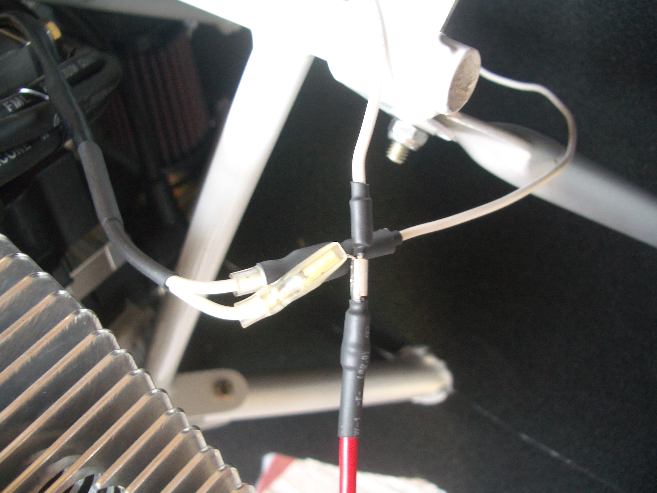

Hi all,
I've just fabricated the link from one of my Jab dynamo leads, connecting this to pin 1 of the regulater and to a 3A in-line fuse, which will eventually go the tach of my EIS. I've posted a picture of how I've linked the 3 wires together and wanted your opinion on whether it's safe or is there a better way to do this? In the picture the white wires on the left are from the dynamo, the white(?) on the right go to the voltage regulater and the red wire at the bottom is the 3A in-line fuse. Am I ok with the piggy-back connector that I've used?
Thanks for your time.
Ian

What you've done is obviously functional. You might
consider bending the tap-tab to make the tap-wire
lay parallel to the main line and then put a larger
piece of heat shrink over the whole thing. A piece
of 1/2" shrink ought to do it.

Thanks Bob for the response. I was going to heat shrink the lot once I was happy it was ok. I did think afterwards that I could have crimped the 2 wires into one spade connector - would that have been a better option?
Ian

It's a constant trade off between what one might call
the best-we-know-how-to-do and something that is sure
to be a failure issue. If ultimate reliability is your
goal, then crimp all three wires together into a single
butt splice or solder and heatshrink. If some degree of
serviceability is desired, then connectors of some
style are in order but then service life goes down.
I've seen builders twist such wires together and put
a wire-nut on them like you would use in a light fixture
on your ceiling.
Loss of that joint doesn't represent a great hazard
to flight if you've designed a failure tolerant system.
So the only thing you need to trade off is the potential
inconvenience of having to repair a convenient joint
in the future or the inconvenience of dealing with
permanent joints when replacing parts. Given that
the PM alternators are exceedingly long lived,
the butt splice or soldered joints are pretty
attractive to me. The choice is yours.
