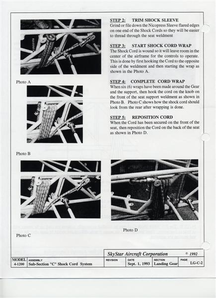

Fox5flyer Guest
Posted: Mon Jun 30, 2008 10:16 am Post subject: Manual Pages |
I posted these a couple months ago for model 2. Should be the same for the 3.
I'll try again via attachment. If they don't come through OK, please let me know.
Deke Morisse
Mikado Michigan
S5/Subaru/CAP 377+ TT
- Joseph Joubert

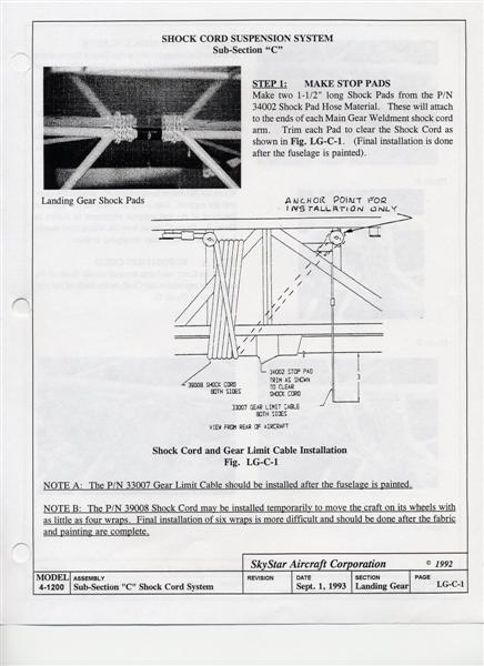

Fox5flyer Guest
Here's page 2 of the bungie instructions.
Deke Morisse
Mikado Michigan
- Joseph Joubert
