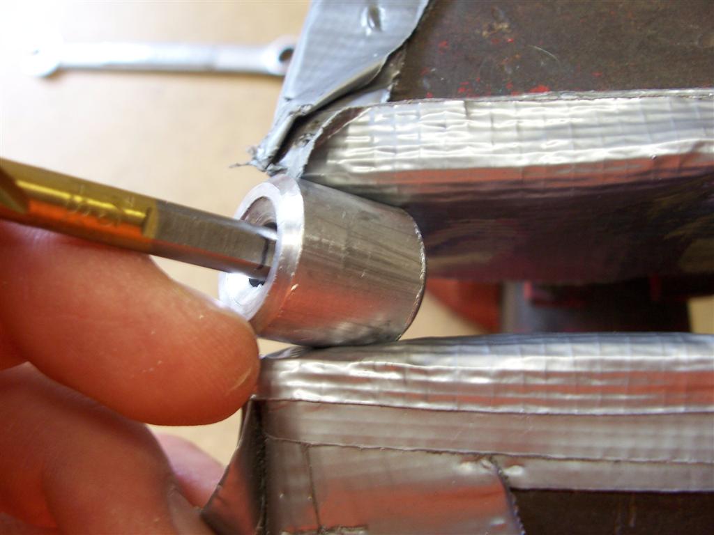

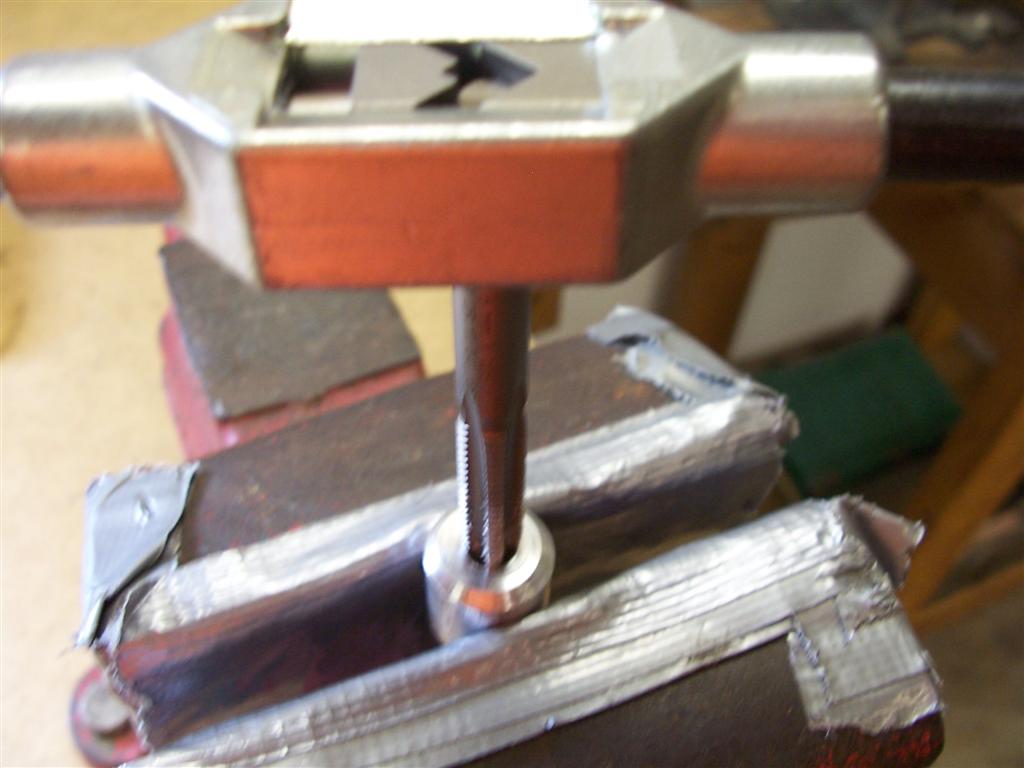

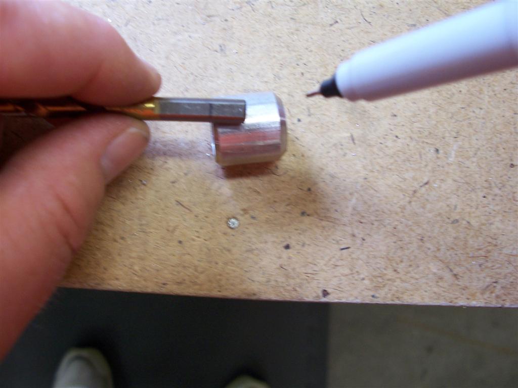

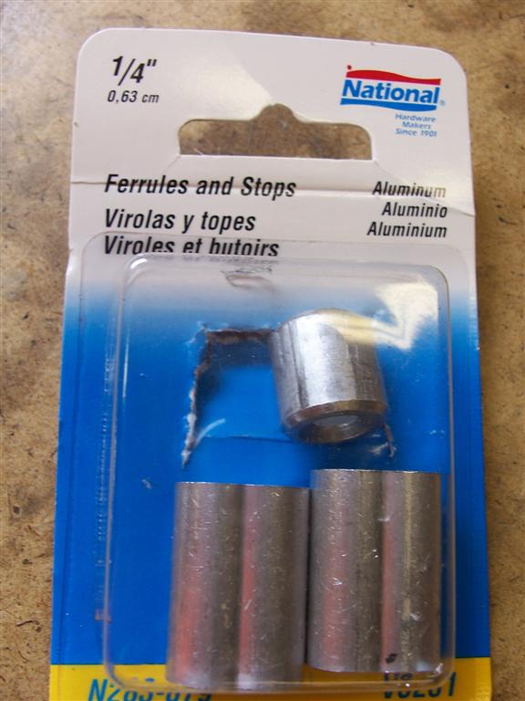

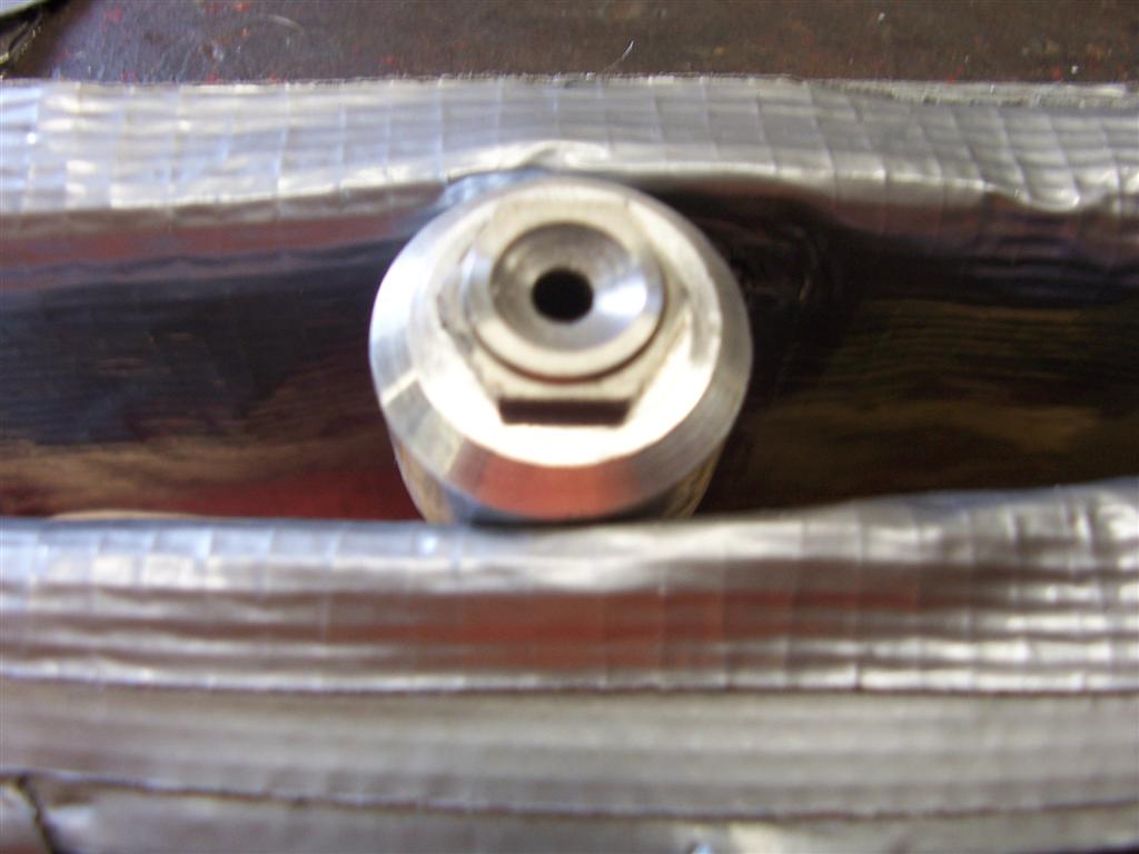

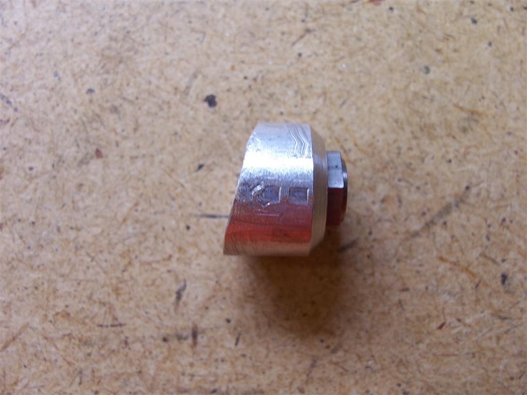

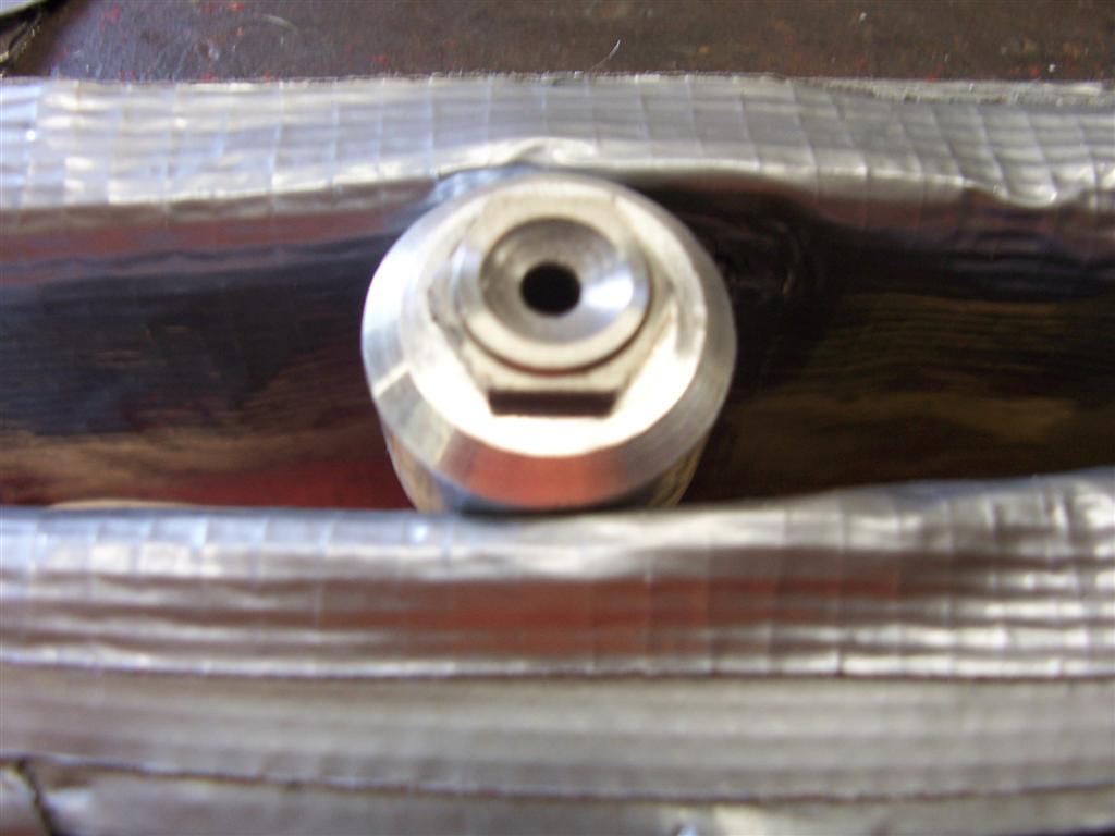

I started by determining the diameter and thread pitch of the riveter head in my hand riveter. I then determined the drill size needed to tap a hole of the same diameter and thread pitch. In my case, my Craftsman hand riveter had an 8mm head with 1.25mm thread pitch, requiring a 17/64" starting hole (essentially 1/4"). I then went to the hardware store and purchased an aluminum ferrule and stop kit with a 1/4" hole (about $2). I took one of the ferrules and threaded the hole using an 8mm x 1.25mm tap. Next I threaded the riveter head into the ferrule, measured the remaining height of the ferrule above the top of the riveter head, and marked that distance down from the top of the ferrule as the lowest point for cutting off the top. Next I determined the angle I needed to pitch the riveter away from the interfering parts (about 10 to 12 degrees), set my band saw to this angle and cut the top off of the ferrule.

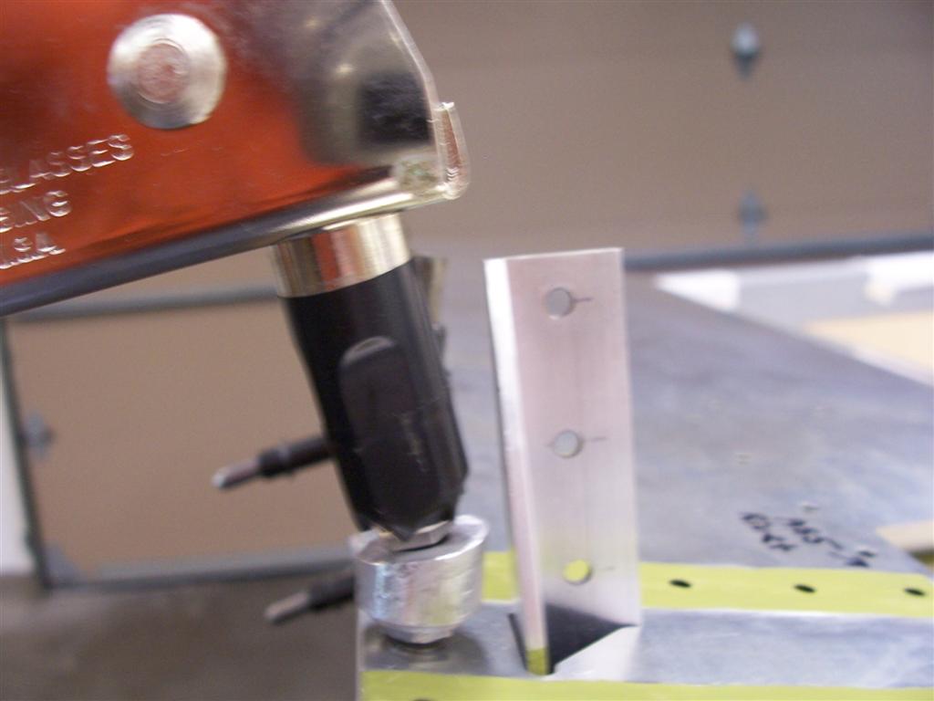

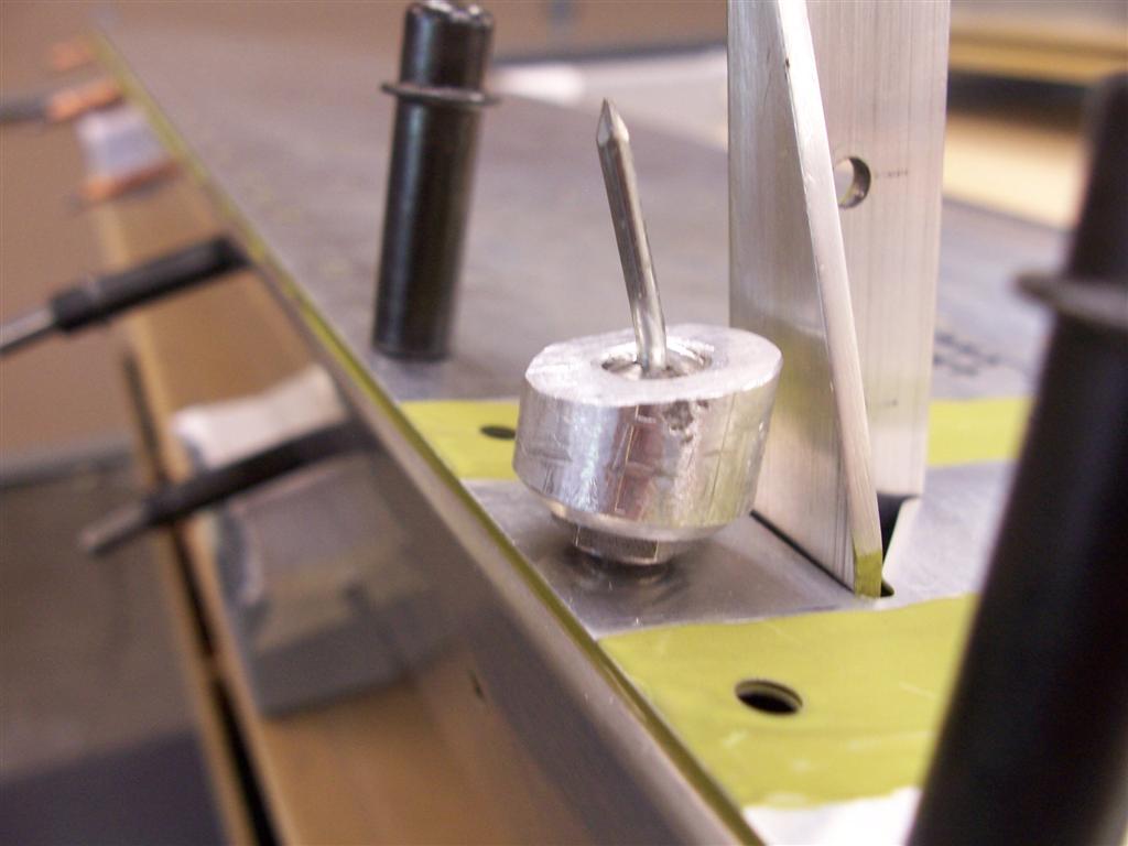

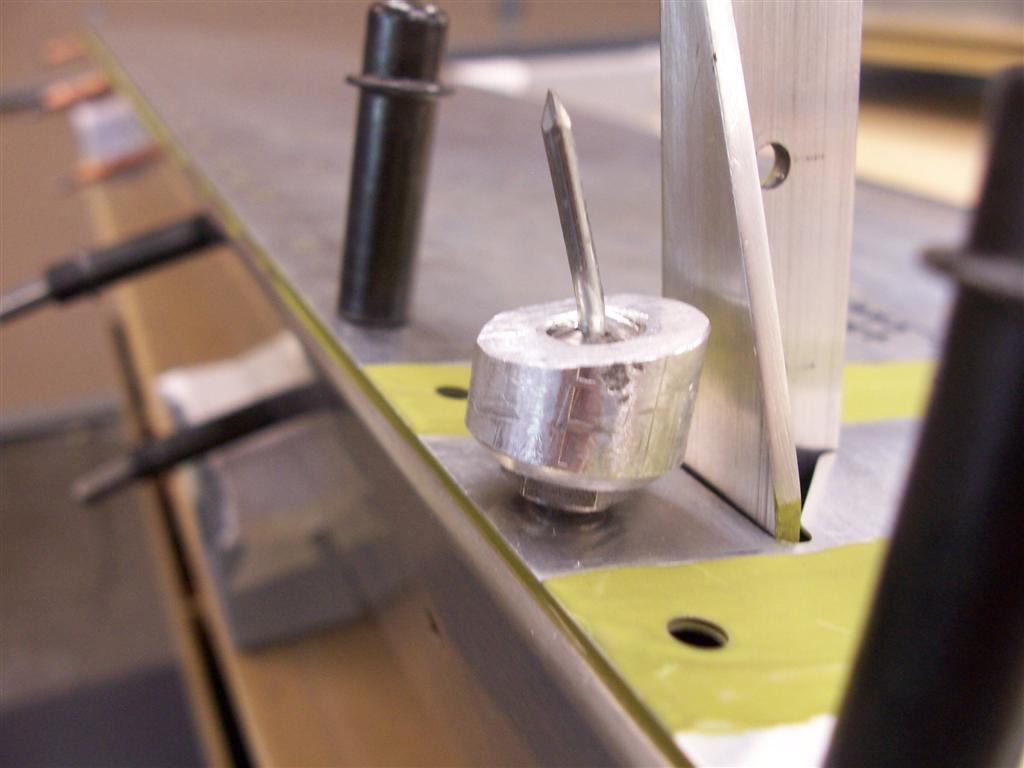

I can use this tool in the same way as the "wedge" adapter in the EAA film, inserting a rivet and bending the mandrel to be perpendicular to the upper angled surface of the adapter, and then pulling it with a riveter.
You may have a problem with grip length depending on the profile of your hand riveter head. I have a low profile head, so the riveter is still able to grab the remaining mandrel that protrudes from the top of the adapter.
# 1 - Aluminum ferrule and stop kit from a hardware store (cost approx. $2).
# 2 - Tapping threads in the ferrule for the riveter head.
 Filesize:  70.13 KB
 Viewed:  441 Time(s)
# 3 - Riveter head threaded into the ferrule.
 Filesize:  66.6 KB
 Viewed:  433 Time(s)
# 4 - Measuring and marking the remaining height of the ferrule above the riveter head.

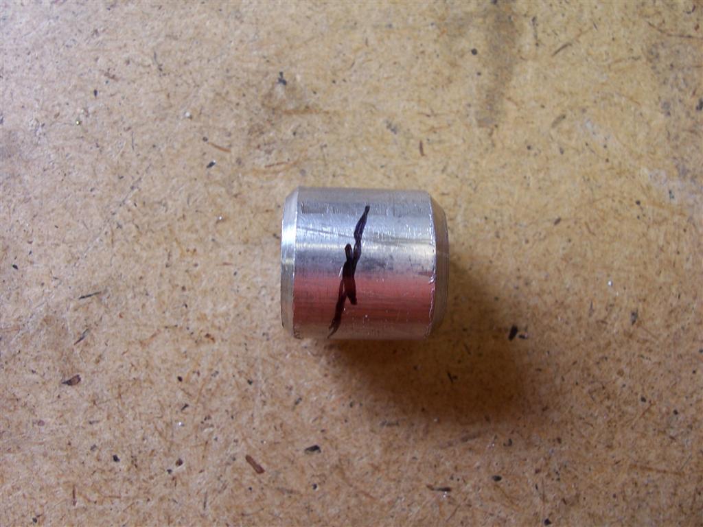

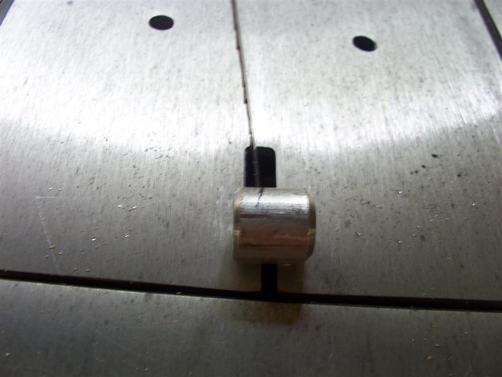

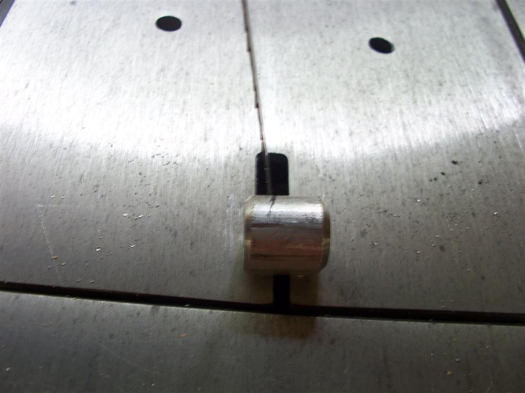

# 5 - Marking off the remaining height on the ferrule as the lowest point allowed for cutoff.
 Filesize:  72.86 KB
 Viewed:  406 Time(s)
# 6 - Marking the approximate pitch on the ferrule for cutoff (not necessary if you have an adjustable bandsaw).
 Filesize:  101.81 KB
 Viewed:  406 Time(s)

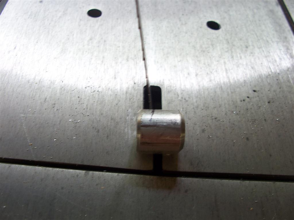

# 7 - Preparing to cut off the top of the ferrule at the correct angle using a bandsaw (a hacksaw could also be used).
 Filesize:  72.61 KB
 Viewed:  458 Time(s)

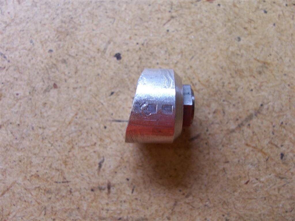

#8 - Completed adapter.
 Filesize:  75.79 KB
 Viewed:  443 Time(s)
#9 - Adapter inserted on rivet, with mandrel bent to perpendicular to pitched surface of adapter.
 Filesize:  61.35 KB
 Viewed:  442 Time(s)
#10 - Riveter inserted onto mandrel - ready to pull the rivet.
 Filesize:  55.55 KB
 Viewed:  459 Time(s)
