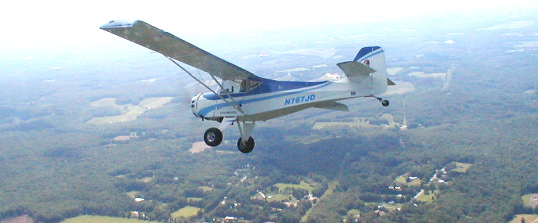

As I said, I had a great day Saturday. I attached a picture taken in flight at 85 MPH. If you use your imagination, I think you can see the position of the elevator trailing edge down. I was pushing and it would seem like this un-faired position might be adding drag. I would like to raise the leading edge of the Horizontal stab, but have been told not to warp it (which it already is a bit set in the middle hole) and I am not apt to cut and weld a longer strut.
As for the midrange skip, I had a two cycle guy move the needle valve. Was it the jet needle, or the needle jet? The one with the four clip positions. He moved it one notch and looked at the plugs after running it and then moved it back in fear that it was running too hot. So I will leave those alone. I guess I might play with the mixture screws; I have not touched those since changing the idle jets.

| Quote: |
<1dillfamily(at)comcast.net>
