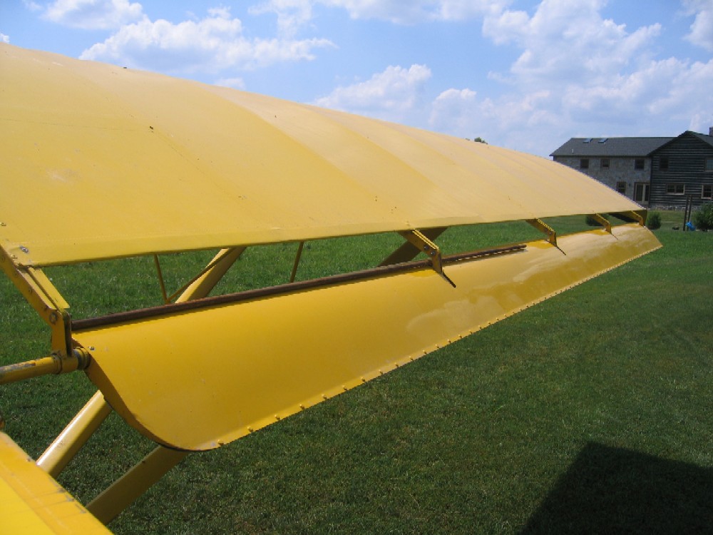

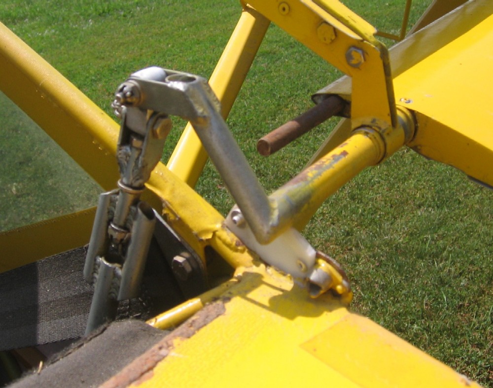

Most important question - the inboard leading edge of the flaperon has a steel rod that appears to have been held in with some putty, no doubt a bad repair. The problem is that the rod is the length of the flaperon, it is loose and slides easily, and the putty must have loosened sometime during taking the wings off and putting them back on. After a run-up &taxi and a post-flight inspection I discovered the putty had fallen out and the rod was extended into the flaperon linkage potentially locking the controls. Thank goodness it was only a run-up!
My question(s) - is this a known problem? How should the end of the flaperon be sealed - it appears the port one has bent-over metal possibly epoxied in place? Should that steel rod be loose, and if not how should it be secured? What's the proper repair given that the end of the flaperon is now open?

It sounds like the steel rod is an attempt to balance the flaperon?
Or is it actually a steel tube? A steel tube is used within the
flaperon...they call it the flaperon spar...and the flaperon hinges
pivot on it. But you say it is a rod, so my guess is an attempt to
balance the flaperon...got any pictures?

Hi Lynn - thanks for the quick response.
I have taken and attached 2 pix for you, being new to the list I hope it
works. The steel rod (PIC1) is about 3/8" solid steel and is 1/2 the length
of the flaperon, In the picture I laid it on top for you to see. PIC2 shows
it protruding from the leading edge where it should be inside and secured.

Bob, the steel rod in the Flaperon is a UK modification to balance it. Here is a link to a service letter that describes it along with some other information about your flaperon system.
http://www.kitfoxaircraft.com/support/service_bulletins/sb9.htm
You can find all the Kitfox service letters and bulletins on the Kitfox factory web site http://www.kitfoxaircraft.com/ click on Technical FAQ.

Thanks Tom, that explains the steel rods (I checked, there is one in the
port wing as well) and the wing patches on all 10 hangers for the aluminum
reinforcement brackets. It will also allow me to answer the inevitable "you
don't have the counter-weights installed(!!??)" that I get every time
another Kitfox owner sees my plane.
I can't however find an installation document for the UK fix and am not sure
how to re-secure the loose rod and seal the end it is coming out of, and
ensure the other one doesn't come loose in flight.
Bob

The UK fix is not a factory fix and the securing of the rods is frought with problems. The counter weights as supplied by the factory will be more secure and lighter. Will also save you having to answer those questions about why you don't have them. Wink
