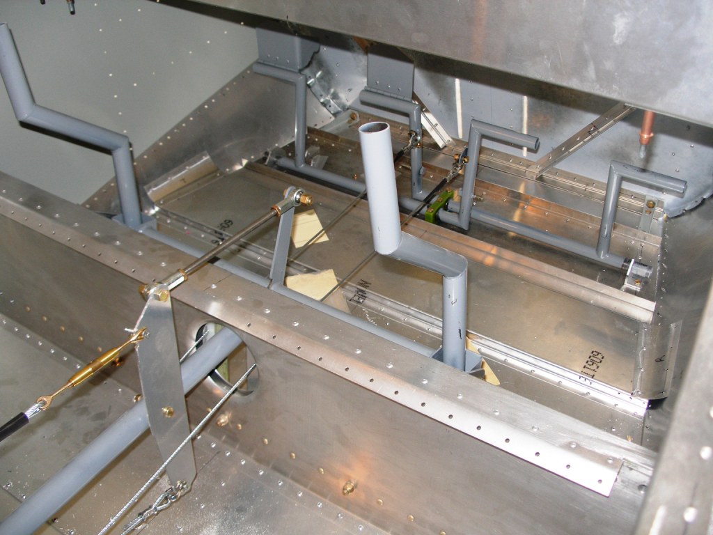

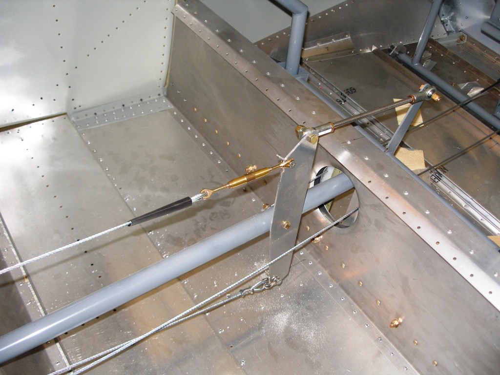

Hi All
I'm working on the control install on a 601XL (with the dual stick option).
I know the rudder cables pass on the outsides of the the torque tube and pre installed angles on the main spar
I checked the zenith builders site and Larry McFarland's "if I don't understand he's probably got a picture of it." place, but his is a HD and things are a little different up there
A picture would go a long way to make me comfortable with the things I'm doing now. I don't want to bolt myself into a corner later.
No I'm not doing any mods, just following the plans.
Now I gotta go look for my belt and suspenders...........
Larry
Jaybannist(at)cs.com

Larry,
These are the only two photos I could find. Let me know if you have questions.
Jay in Dallas

PostPosted: Sat Jun 21, 2008 3:13 pm    Post subject: Re: Need Picture of Rudder cable Fairlead install Main Spar Reply with quote
Jay
Those were Great!!! Just what I needed. I was unsure that small of a space for the cables to pass through was enough.
Those shots answered all of my questions
