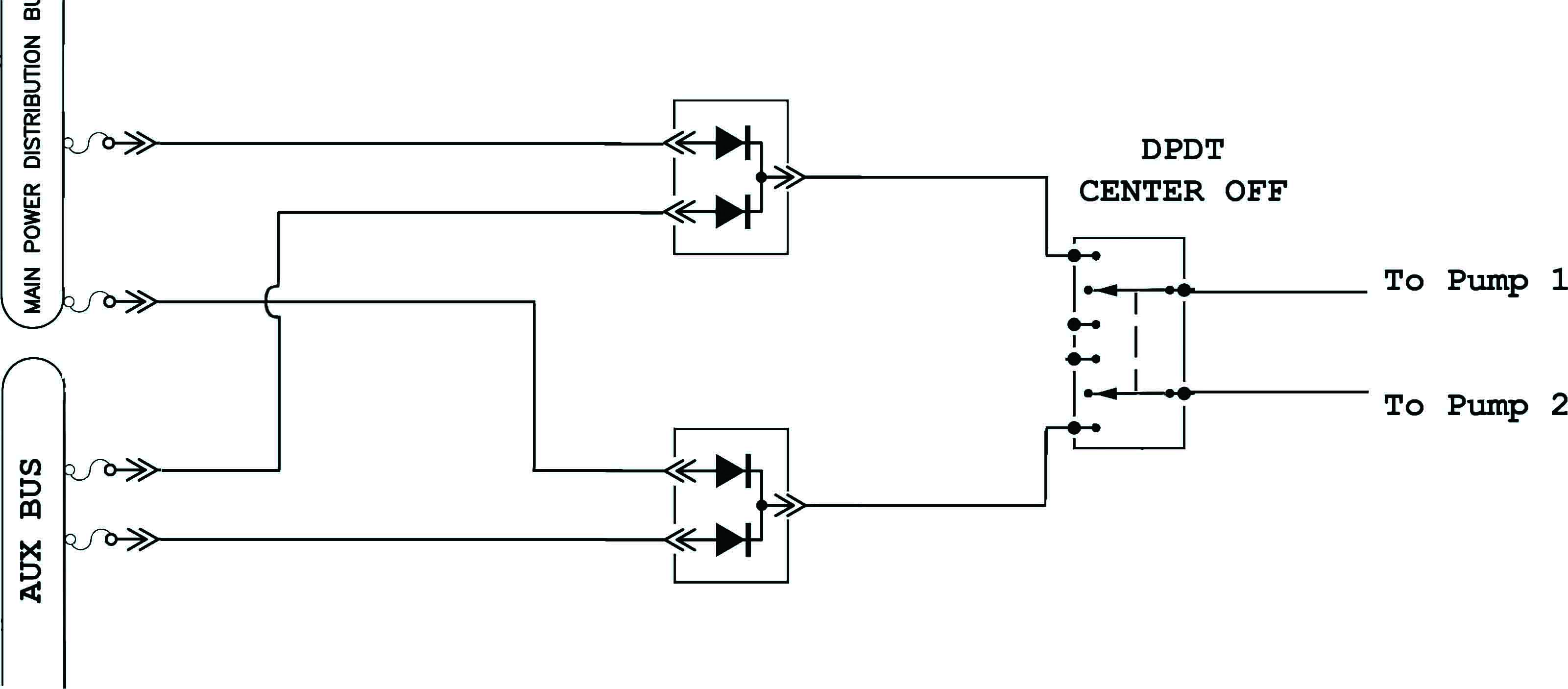

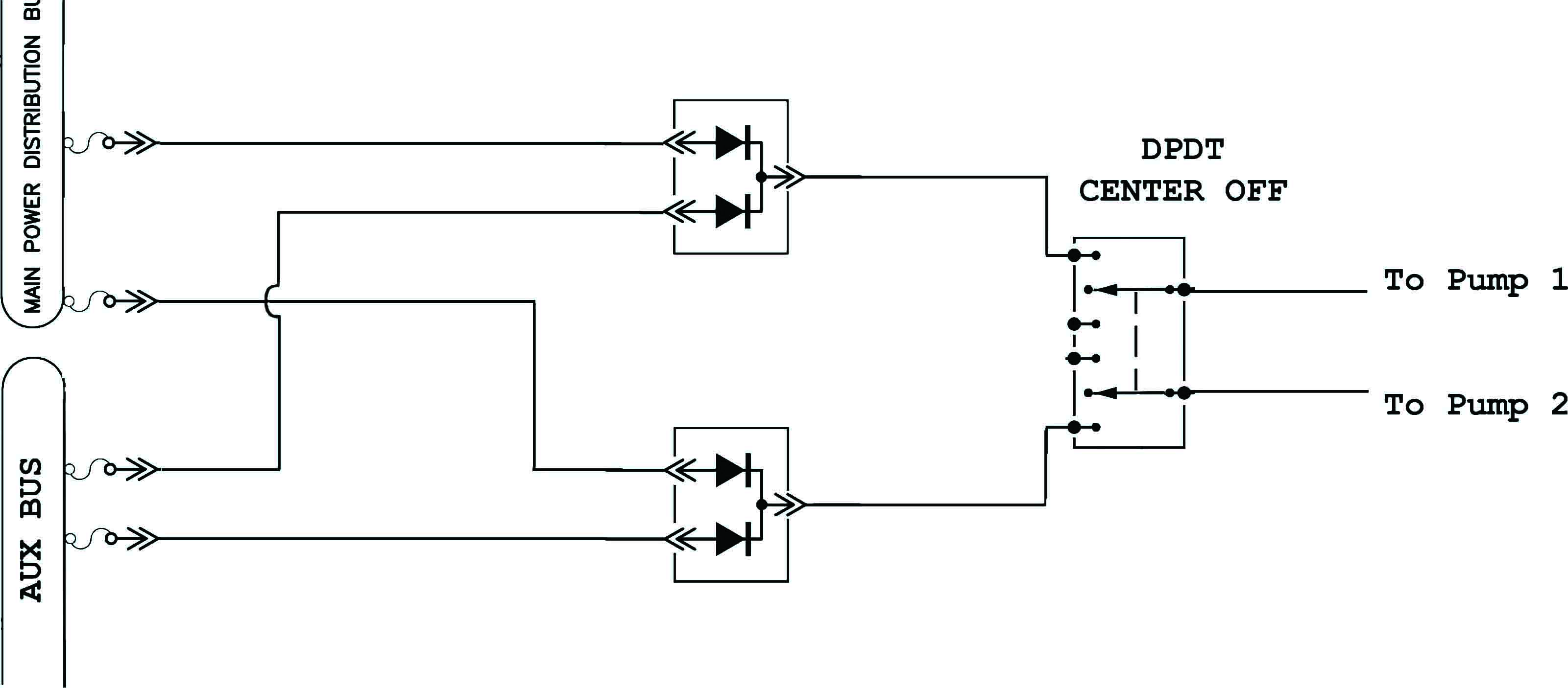

All,
I am looking for a better way to handle switching for my fuel injection fuel pumps. I have uploaded the diagram here:
http://www.mistakeproofing.net/transfer/N202SH_POWER_DISTRIBUTION_06.pdf Look in the lower portion of the drawing.
I am using the RWS fuel/ignition controller which has the ability to receive power from two sources, which should fit well with Z-19.
However, I have added a backup fuel pump. I have a selector switch that determines which system supplies the fuel pumps. Then, I have added a switch that will allow me to run either pump, but not both.
The problem is, I have to feed each pump through two switches, doubling my chance of failure.
Any suggestions?
Thanks.

Why are you using a double pole switch for "System B Engine Secondary" ECU instead of a single pole switch?
Suggestion for Ignition Coil +12V Supply: connect switch terminals 1 & 4 together and terminals 3 & 6 together for redundancy.
Would it hurt anything to have two pumps running at once? It would greatly simplify the circuit to have one switch for each pump, with each switch having 3 positions: source A, OFF, source B. It would be up to the pilot to make sure that only one pump in turned on at a time.
If you absolutely have to prevent both pumps from running at once, let me know and I will draw a circuit using either 4 switches or else 2 switches plus diodes.

Posted: Mon Jun 16, 2008 5:58 pm Post subject: Two Fuel pumps Z-19RB |
Sam,
How about the attached circuit? Four fuses are necessary in case a pump shorts out and blows two of them. The switch is still a single failure point. It would be better to tolerate two pumps running at once. It would seem that regulators should be available to handle the flow rate of two pumps. If you do not want the voltage drop of diodes, two of SPDT switches could be used instead of diodes. The more complicated the circuit, the greater the chance of something going wrong.
Joe
