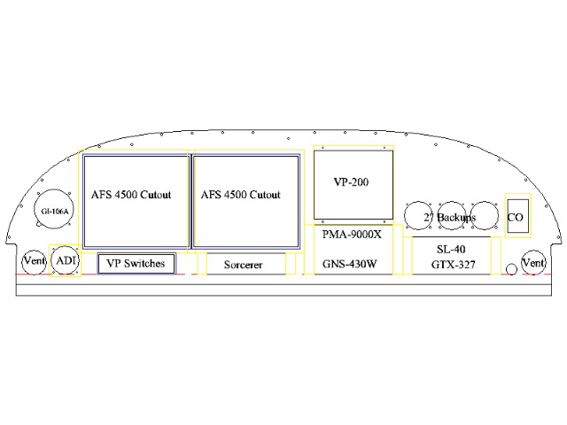

I'd like to get rid of the line of nut plates along the bottom of the panel to make the whole lower flange area of the panel (F-1003B) useable without interference and still have structural rigidity.
I understand one alternative might be Stein's extended panel but I'm concerned about conflict with forward movement of control stick.
Another might be to have a single piece panel cut with support brackets on the ends and no separate lower flange.
It's a really tight fit for two AFS 4500's on the pilots side plus three 2 & 1/4" backup instruments.
Has anyone come up with alternatives. Especially those that are actually flying Laughing
Additional comment: Since the EFIS mounting will require the radio stack to be off center, I'm looking for a flat metal panel as opposed to one that has been cut modular with the radio stack directly in the center.

You can design your panel in CAD and have it cut by a laser or
waterjet shop quite easily. Then you can either use the ends of the
Van's bar to hold the panel at the sides of the airframe of you can
develop some other sort of support for the lower side of the panel. I
can't imagine that two #3 rivets in either end of that really do that
much structurally to support the bottom of the panel. Also, if you
use the standard system, then it is always in the way when you are
working behind the panel, either with part or all of it out. If you
use a one-piece panel (at least one-piece from top to bottom) you get
a LOT of extra real estate. However, to get two 4500's in the panel
and a good radio stack and backups, you will likely need to make it a
little bigger than standard. I am in the process of helping someone
make one (see attached drawing). Those 4500's take up a lot of panel
space, but the functionality and ease of use with the 2nd knob and the
joystick seem to make that worth it, as well as the processor and
brighter screen.
By the way, splitting the panel horizontally is very helpful in
installing and removing it. That area is very tight for a single-
piece panel, not to mention the hastle of needing to remove the entire
panel to work behind part of it.

I am not so sure about the placement of those vents.
I think that they might fall more easily under the panel lower flange
