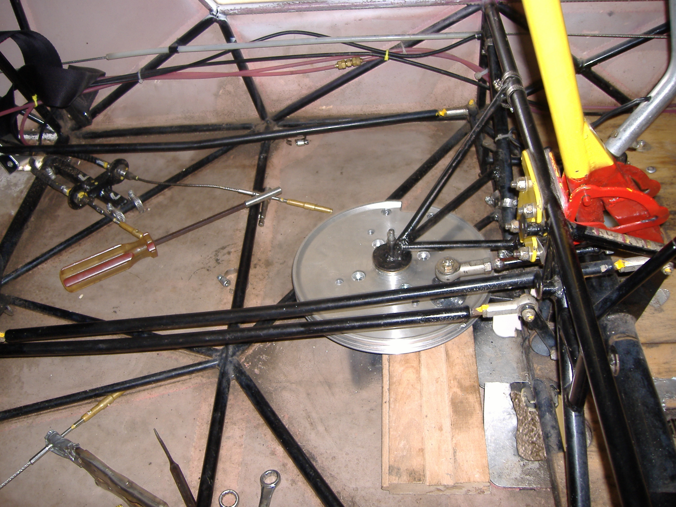

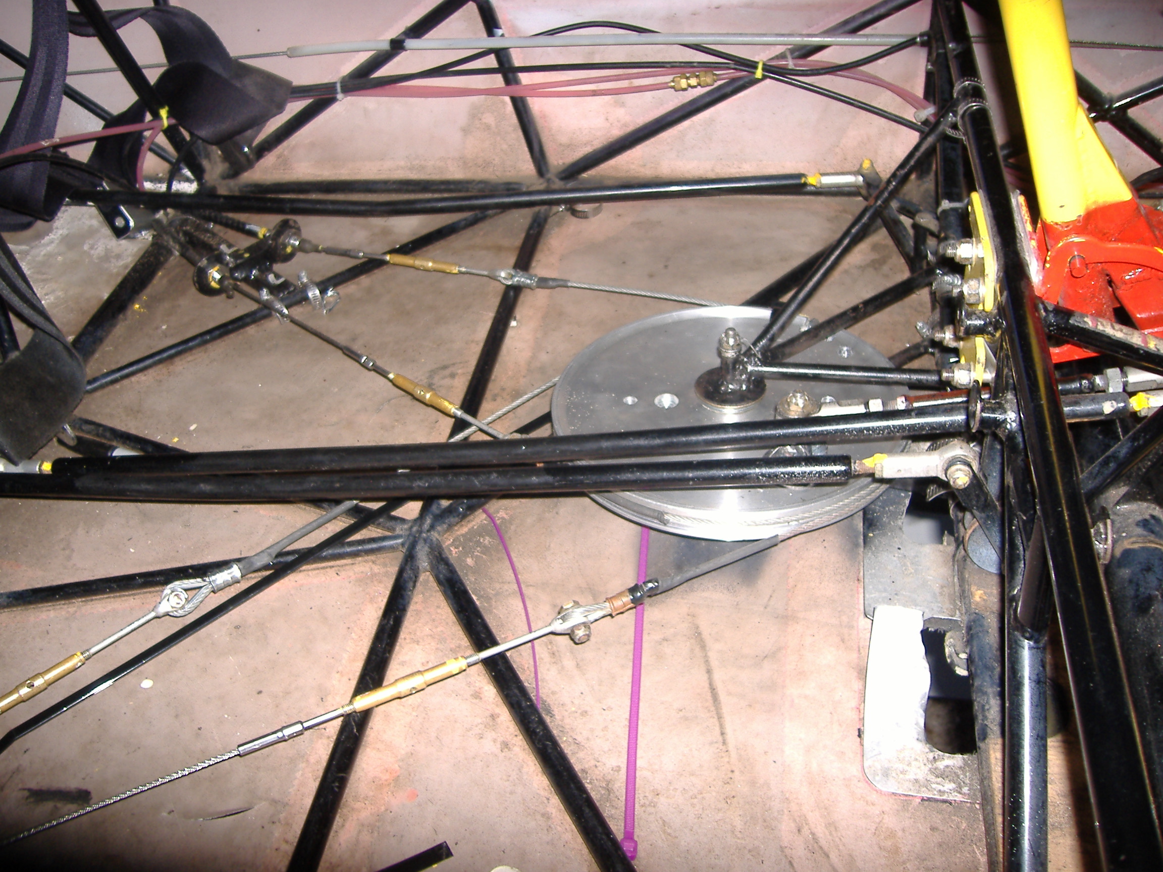

When i got my 1100s all i got was the floats, struts ,spreader bars and the johnson bar and cables from floats. I made the bullwheel and all 4130 fittings that goes under the seat. you need a good pull....... how much ? well i would guess 50 to 80 pounds at the most. It helps to have your should belt on.

| Description: |
| Filesize: |
1.02 MB |
| Viewed: |
528 Time(s) |
| Description: |
| Aerocet Gear pulley, bullwheel and fittings that I made |
| Filesize: |
1022.65 KB |
| Viewed: |
503 Time(s) |
