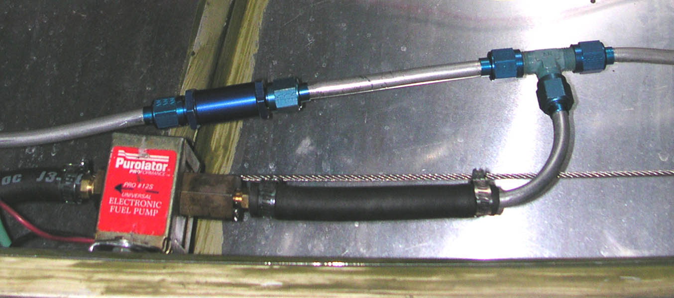

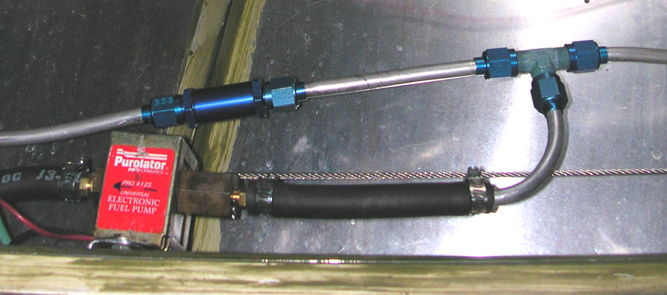

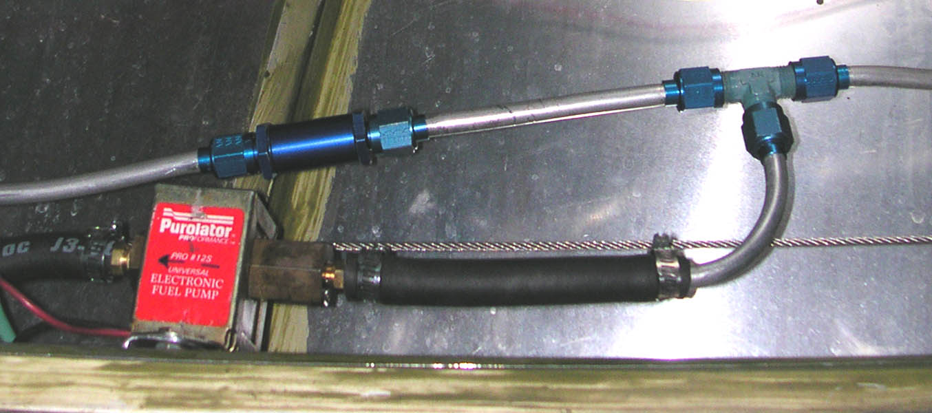

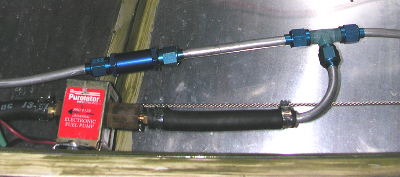

serves as a gascolator).Gravity feeds to a boost pump beside the door on the
bottom of the rear fuselage then gravity or boost to the main fuel shut-off
on the centre sub panel. (A bypass loop with a check valve is "T" eed in
around the boost pump to allow gravity feed to bypass the boost pump when
"OFF" see photo att). From the main shut-off, fuel feeds the engine pump
through a filter then to the cross and the carbs.

 Filesize:  127.63 KB

Have you considered series connection for your fuel pumps? That is, to run the line from your header tank thru the electric boost pump (which by the look of it has through pass ability) then through to the engine driven pump and filter.
As far as I know these pumps seldom fail thru blockage which is the only feature of a parallel system. Series connection is widely used in GA carburetted fuel systems.

A very good question. To be honest I personally prefer my previous parallel
system. I like the redundancy especially of pump and filter.
Apart from the bypass and check valve I consider the new one a series
system. One can argue the check valve only complicates things for little
benefits.
As you have noted, the bypass around the boost pump is primarily to defeat
the unlikely failure of the boost pump blocking the line. It also adds an
alternate path around that pump to facilitate flow.
Assuming check valve failure modes of either open or closed, open nullifies
the boost pump but engine pump pressure continues at 4.5 lbs; closed, boost
pump operation remains normal and pressure should increase to 5 lbs when it
is selected ON. When selected OFF at high power settings I suspect pressure
will fall below 4.5 lbs because greater restriction through the boost pump.
Either requires a double failure to affect engine operation.

The parallel system with a check valve is a good idea, just need to make
sure the check valve opening pressure is not significant (some are). A
lot of pumps can severely restrict flow if they are not actually pumping.
I have a Weldon 8163 in my Kitfox which has a built-in Bypass. I had
at one point called Holley about their Blue high pressure pumps, and
they told me over the phone to definitely not use their pumps in series
if they were not going to be running as they would restrict flow 50%
or more.
I have an Andair check valve in the shop, and I know from testing it
that it requires at least a couple psi to open, which depending on the
application might be a problem.

Thank for the info on your electric pump. I wish I knew more about the
internal construction to judge their flow through properties.
My check valve is a "Free Flow" from ACS p/n 10630, is spring loaded but
requires less than one PSI to open, one oz and takes 3/8 fittings.
I fully support your comment on venting collector/header tanks.
