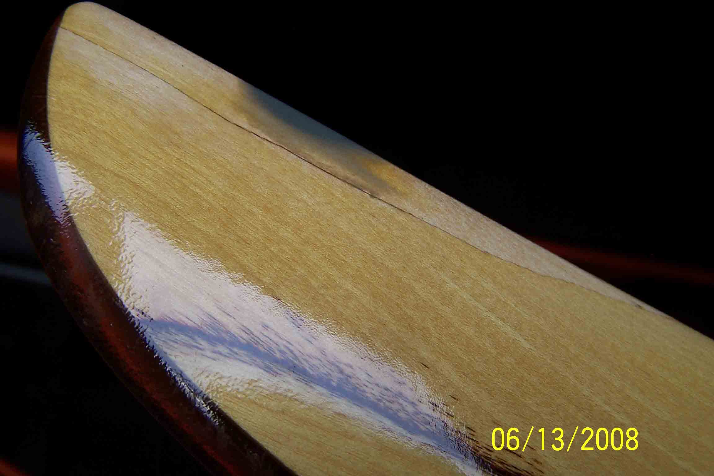

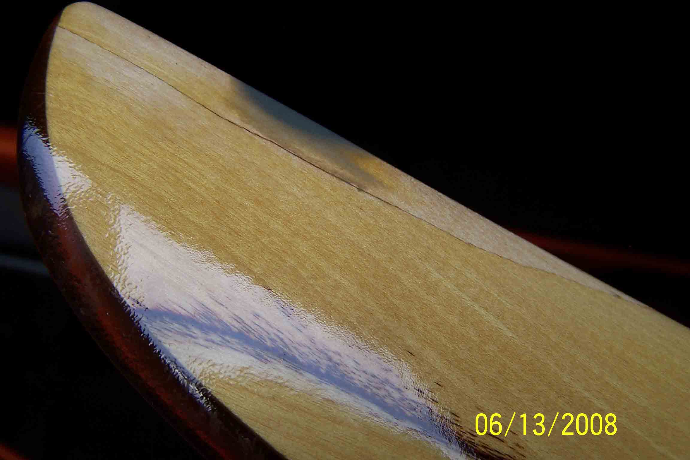

Well, it wasn't weather this time or getting the flu that is going to
keep me from heading south, but a "stupid pet trick." I was doing a
compression/leak-down test today, and my buddy was holding the prop,
and I told him to let it go, but get his body and hands out of the
way, and he got all but one hand out of the way, and it bit him when
the other blade came around. The two of us both made a mistake....me
for wanting him to see how the blade would snap around when released,
and him for not being aware of the other blade coming around. It cut
his hand for about a 1-1/2" gash, and stung pretty good, and put a
dent and crack in my prop. So once again, fate has put the damper on
another trip for me, and for him, unless he decides to go anyway. I
feel real bad for him, because he's wanted to get away from here for
so long, and now he may not go after all. The injury wouldn't keep
him here, but just having this happen is such a bummer. The dumb part
of it is I had the leak-down test all done, but when he drove up, I
wanted him to see how the test is done, so I had him hold the prop to
see how much effort it took to do so....bad decision on my part.

Well, the trip to VA is off, but I did get my prop glued back
together and flew it today, so I don't have to wait the 10 or 15
weeks to get a replacement prop. I'm still thinking of the Prince P-
Tip, and since they are less than an hour from me, I'll have to bop
on down there and look the place over and get more info on them.
Sure nice to have the ease of repair that a wooden prop allows, and
the blessing of the FAA (being the builder of the plane) in being
able to do these repairs...I feel sorry for the spam can guys who
would have to do the wait, worry, and pay, before flying again.

I might as well fess up the whole stupid story, as long as you asked.
I only sent the details to a "lister" who asked, but here's what I
did, and maybe others will benefit from it. This is what I wrote
earlier:
Well, by golly, after thinking it was going on the wall right next to
a deer head, it might just make it after all. I began by thinking
that I didn't want to trust a questionable $600 prop on a $13,000
engine (today's price), but after hearing 10 weeks for Sensenich and
15 weeks for a new Prince (and $1500), I decided to see if I could
fix the crack. The cracked piece is about 3/8" wide and 4 1/2" long,
but still fastened to the rest of the prop. Well, now it's fastened
even better. I dribbled Super Glue into the crack and held it
together, then moved further along and glued some more, etc. By the
time I got to the end of the crack, I could barely flex the joint
open enough to get more worked into the crack. There was also a dent
on the edge of the cracked piece. Recalling my wood-working days, I
sanded the finish off the dented area, and wet it down with water.
Then I fired up my model airplane covering iron, and ran it over the
dented area. Lo and behold, the dent almost came totally back to
level with the rest of the prop. I sanded the cracked area flush, and
mixed up some Hysol and applied it into what was left of the dent and
it is hardening in the sun right now. I really think it's going to be
ok after all...time will tell.
While the glue was setting up, I talked with Lonnie Prince of Prince
P-Tip Props, and asked about a new prop. This is when I learned about
the 15 weeks delivery time. For 50% more money they will crank one
out in 15 days....thanks, but no thanks. He really sounds like a good
guy, and he even gave me some pointers on fixing the crack, which I
would have followed if I hadn't already had it stuck back together. I
only live about 75 miles from his operation, and he said it'd be ok
to visit and see how they make the props....but he said "wear your
work clothes."
His props sound like the best of both worlds, as they flex from a
climb pitch to a cruise pitch as the load on the prop changes. I'm
awfully tempted to order one of them. He also said that if the prop
doesn't satisfy me (or anybody), he will re-pitch it, or build a new
prop, and cost would be only the shipping involved. That's a pretty
good guarantee in my book.
Part of my motivation in fixing the prop was imagining that I was
stranded in Alaska, or out in the desert, and having this
happen....I'd damn well fix it under those circumstances, and fly it
out of there with caution. As Lonnie concurred, fly it carefully,
with one hand near the mag switch, just in case the piece let go.
Actually, the piece is probably so thin and light, that it wouldn't
cause a radical out-of-balance condition, but would allow for a short
flight to a favorable landing area.
Lynn
p.s. I probably would not want to trust this prop going over the
mountains into Virginia, but a few flights around here will prove the
fix one way or the other.
So there it is, the whole sordid story, which came out a whole lot
better than I first expected it to. I was looking at a down time of
at least 10 weeks, but 24 hours later, all seems to be well. After
the repair, I flew it from my place and landed a few miles away, then
took a lap around Michigan International Speedway (at 4000' ) then home.
Just to further explain the crack, it was on the trailing edge, as
the engine was rotated backwards by the air pressure when he let go
of the prop. (Don't try this at home) This Sensenich prop has a
plastic (of some sort) leading edge, and the leading edge wraps
around the tip, and this edge helped hold the cracked piece onto the
prop. I don't know why I didn't shoot a picture of the damn thing
before I repaired it, but I'll post a shot of the repair later.
You know me well enough Duane, to know I'd have to give a repair a
shot....I've got just enough "shade tree mechanic" in me, and lack of
better sense than to just sit still for a replacement prop to show
up. : ) Gotta keep rackin' up those hours if I'm gonna catch you!

Duanesky-
earlier:
work clothes."
Lynn
before I repaired it, but I've posted a shot of the repair below.
good sense than to just sit still for a replacement prop to show
up. : ) Gotta keep rackin' up those hours if I'm gonna catch up to you.
Lynn Matteson
Kitfox IV Speedster
Jabiru 2200
Status: flying w/528 hrs
On Jun 12, 2008, at 5:59 PM, Rueb, Duane wrote:
<ruebd(at)skymail.csus.edu>
Lynners:
What the H. happened to your prop? Did it come un-glued? Wow that
is big medicine to have to fix a prop!
Duanesky

A word or two about the picture that I posted earlier on this thread,
just to answer those who might question my sanity (any further):
The white area at the bottom of the prop is a reflection, as the
light was coming from behind me, and I didn't feel the subject was
worthy of me wasting my time to try to rig up a diffuser, or
reposition the sunlight. : )
The dark area and specks of dark in that reflection area is the
recorcinol glue used by Sensenich to glue the laminations together.
The grey area on the cracked portion is the Hysol Structural Adhesive
that I used to build up the area that did not respond to the water-
soak and heat treatment.
After re-attachment, dent removal procedure, filling and sanding up
to 600 grit paper, I sprayed the repair with spar varnish as used by
Sensenich. Oh, yeah, I also sprayed the other end of the prop to try
to keep the balance as close as possible....shadetree? You betcha,
but any port in a storm, so to speak.
The joint is secure, and there is not a bit of surface offset or any
other way to determine that a repair was made other than visual...the
joint passed the "fingernail test." If I handed you the prop
blindfolded, you would not be able to find the repair. You might feel
the carcasses of dead bugs, however. It may fly off the prop
tomorrow, but it has lasted the 1.4 hours of testing so far, and I
suspect it'll last a bit longer.
