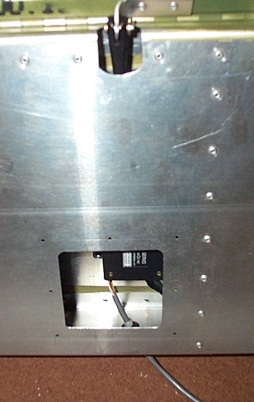

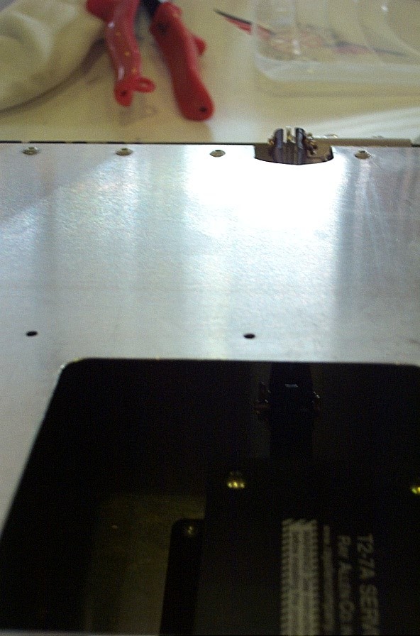

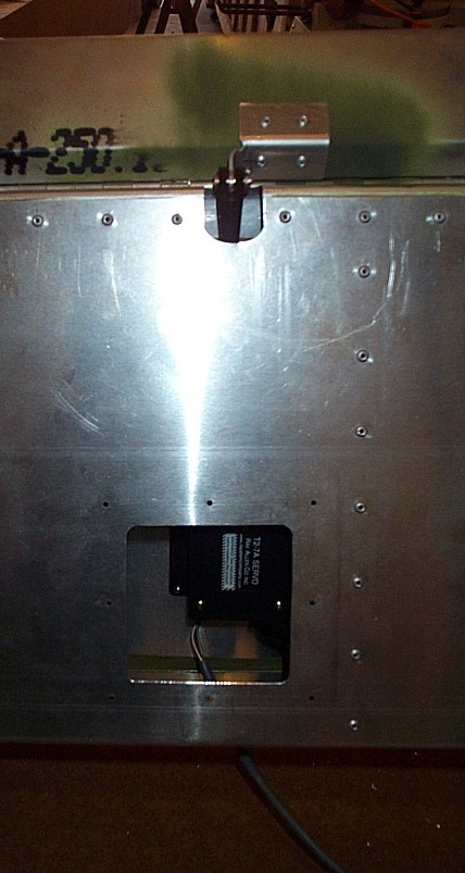

Here are some pictures of my QBK servo installation. I had no problem with getting the servo lined up.
