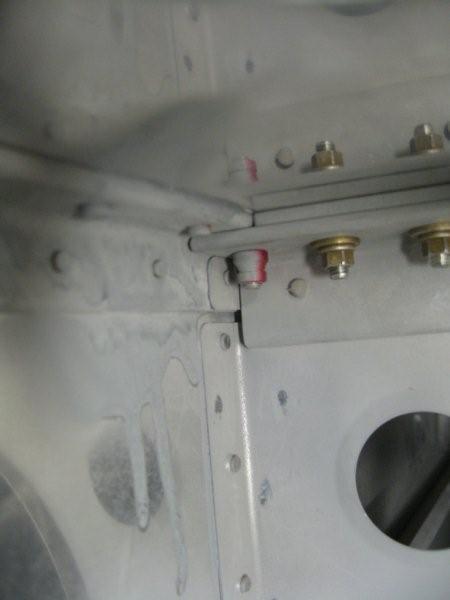

My discussion with Vans indicated the tab riveted to the longeron just to
the left of the red collar is the tab that showed cracks.

IF THAT IS INDEED THE PROBLEM, IT SEEMS IN MY OPINION GETTING RID OF THE TAB WOULD BE BETTER THAN TRYING TO USE A DOUBLER. THE TAB CURRENTLY AS IS IS LIKE THE PULL TAB ON A COKE CAN, IT SERVES AS A WAY TO START THE TEAR.

we also considered getting rid of the tag but it will take a pencil grinder and some contortions getting a view of the work while grinding. As an alternative we are considering creating a radius so that the sharp corner does not exist and prevent the tear in the first place. If that is not sufficient and we do install the doublers,we will not pull up the top but work through the top holes and probably install doublers that will also hook to the external skin as well. a flange for the part exist but no pilot holes are in it. With just 33 hours TT we have a while to think on this problem.
