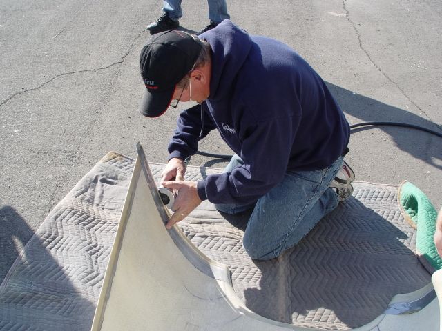

OK but here is a shot of Jim from Jabiru Pacific trimming a cowl at the FWF
class at Quality Sport Planes. He seemed to treat it as standard operating
procedure.
