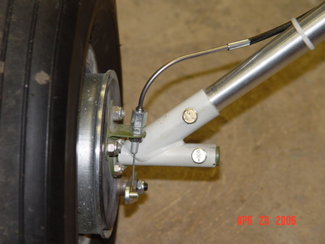

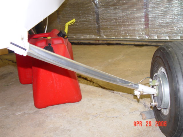

Hi Ben,
I put 5" drum brakes on my Firestar... I didn't know they were
running 4 1/2" on them.... My 5's seem just fine....
http://www.geocities.com/planecrazzzy/LSXIII.html
It's my "Cheap" tires that are outa round.
Some of the guys use "Band" brakes...Supposed to be pretty good.
Gotta Fly...
