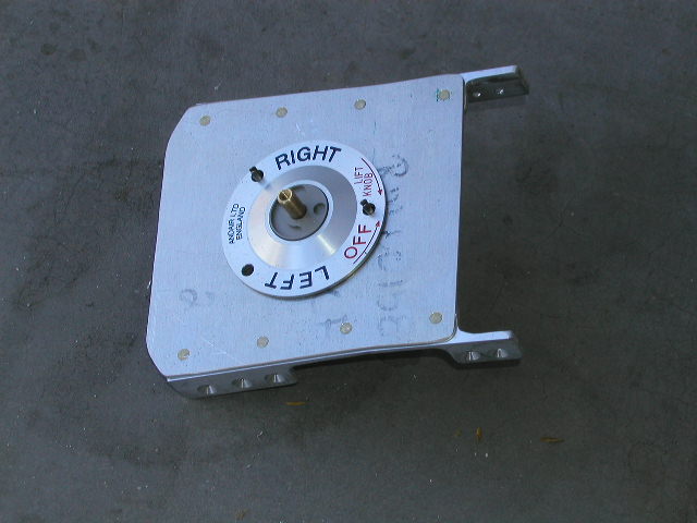

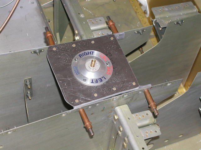

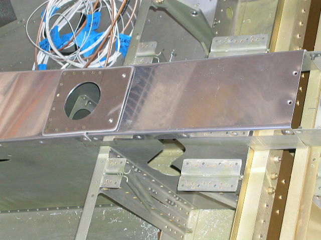

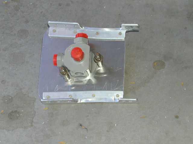

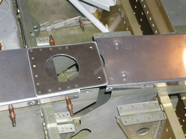

Have included pictures what we have done to install Andair valve as supplied
by Vans and also solve the removal problem of the forward tunnel cover.

Are you sure this will fit in your tunnel? Install the 90 degree
fittings and then the rudder cables and fuel lines, I think you will
find there is not enough room for everything. I did the same type
installation as you did, but moved the valve forward in the tunnel
approximately in line with the exit of the rudder cables to the rudder
pedals. Much more room up there and no issue with the cables rubbing
the fuel lines....

If you want the valve in the same location as original you'll need to
get the extension kit for the handle. The interference issues listed
below can be worked out but when you add in the 2" SCAT for the rear
heat it becomes unworkable without relocation and/or the valve
extension. Tim Olson has several good pictures of the valve with
extension on his website and my installation is almost identical.
