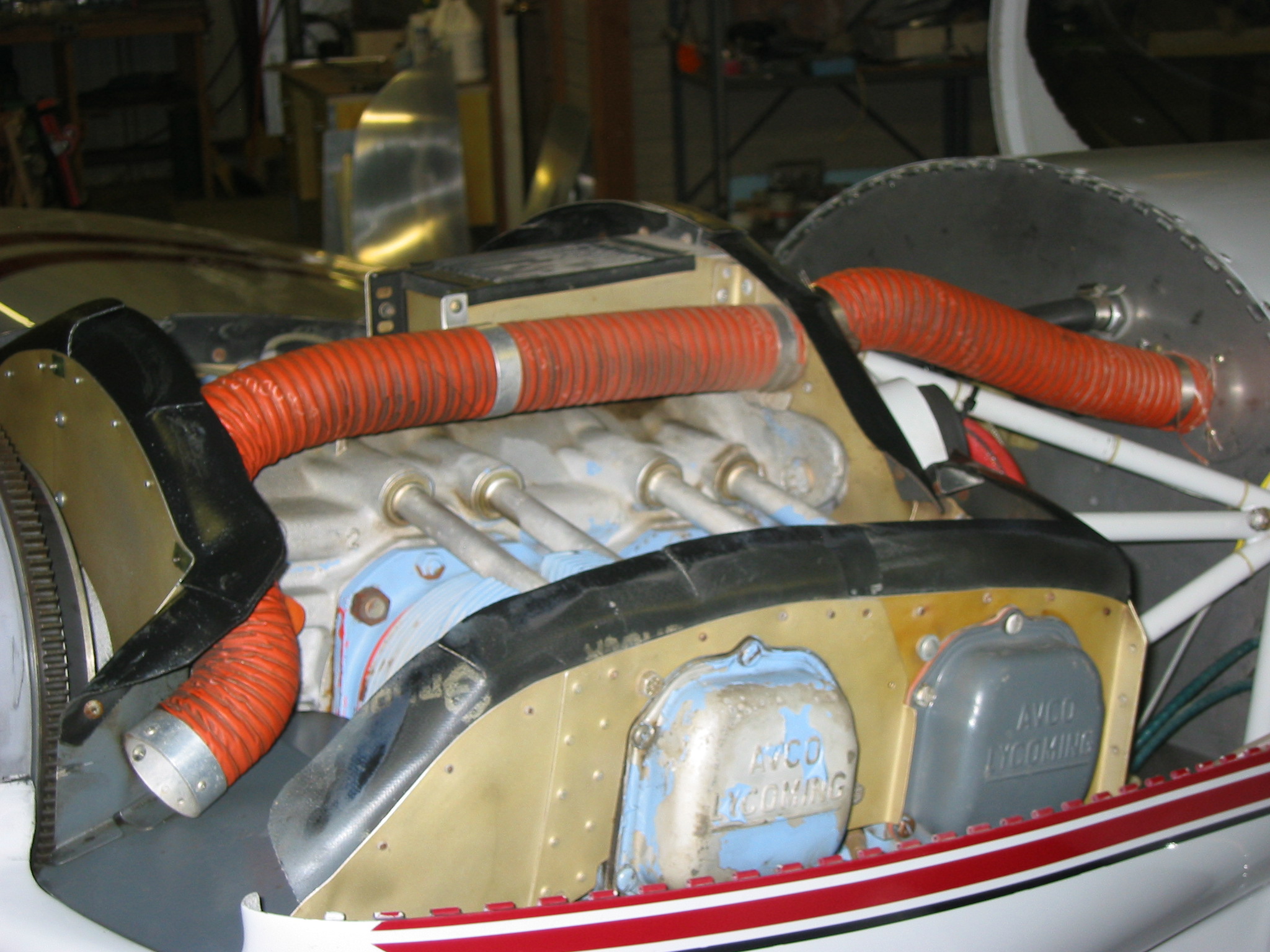

baremetl(at)gvtc.com Guest
Posted: Thu May 22, 2008 3:33 pm Post subject: Cockpit Cooling |
Jim,
Here is a picture that I have readily available. I'm not sure how to send to the list, so if the picture doesn't come through, send me your e-mail address and I can send it directly to you. If you need more detail, I can take more pictures this weekend.
Ivan Haecker

jrstone(at)insightbb.com Guest
Posted: Thu May 22, 2008 4:14 pm Post subject: Cockpit Cooling |
I got the pic, thanks Ivan.
Jim

RR
--- On Tue, 5/27/08, Jim Stone <jrstone(at)insightbb.com> wrote:
[quote] From: Jim Stone <jrstone(at)insightbb.com>
Subject: Re: cockpit cooling
To: rocket-list(at)matronics.com
Date: Tuesday, May 27, 2008, 9:33 PM
Hey Rob,
Doesn't that snorkel pick up exhaust fumes?
Jim
