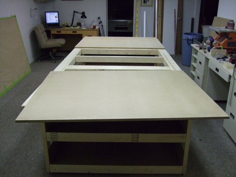

You might want to make that four, since I too am building in the basement. The reason is because it's cool in the Summer, and warm during the cold Canadian Winters.
I can get everything out, except for the fuselage, which will be disassembled, and rebuilt in the garage.
Bob the 701 scratch
