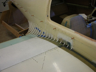

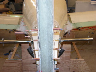

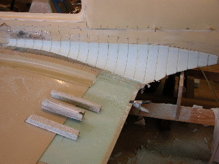

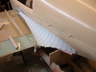

In the interest of drag reduction, I've been working on a fuselage/wing
fillet which mates w/ the standard XS wing fairing just forward of the
spar. Of necessity, a portion of this fillet will be attached to the
wing, a portion to the flap, and a portion to the fuselage. I am trying
to establish the location of the joints, and the extent to which the
portion attached to the fuselage can extend beyond the surface of the
fuselage without impacting the wing when trailering is the big unknown.
A few pixs below explain the general form this fillet is taking
Your assistance would be much appreciated.

Hi! Fred.
You need to take care to allow for wing deflection with your fillet
fairing and can easily finish up with it too tight making it difficult
to assemble the wings and causing fretting on the fuselage sies. Too
loose and you finish up with gaps. Your shapes look good. However take a
look at my "rendition" at ......http://www.crix.org.uk
Of course I don't know what contribution to drag reduction it makes but
I believe it saves air run off the flap inboard end with flaps deployed
to a degree and it blocks off the flap actuating tube slot.
Bob H G-PTAG
