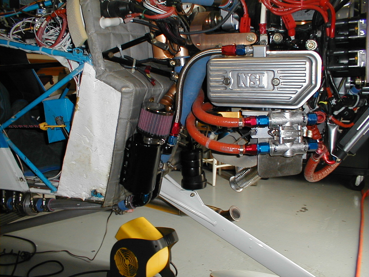

Posted: Fri May 23, 2008 7:51 am Post subject: NSI parts |
If it is not turbo you can go to a smaller unit but here is a pic of how I did mine. I highly recommend the thermostat by pass unit. I have seen the coolers mounted on top as well, think John Anderson did it that way. May be some old shots stored. I don't have the cooler but I still have the breathers and some other NSI related gear to include a turbo block prepared by RAM.
