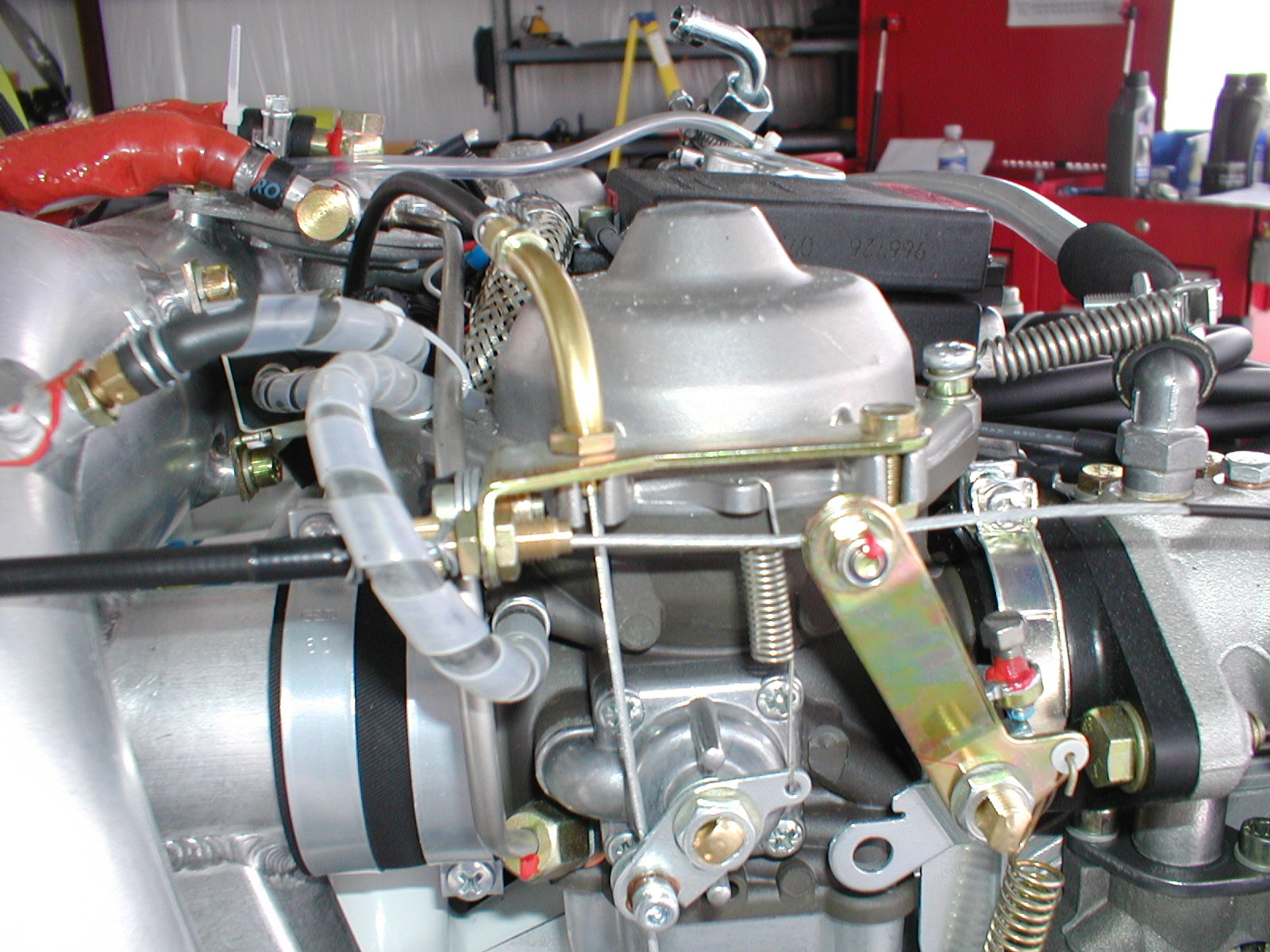

Roland,
Here is a picture of a CT carb I snapped at Lockwood showing the linkage. It has the "super deluxe" adjustable cable ends and shows the threading of the cable I was talking about.
      Dick Maddux
