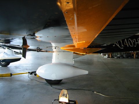

PostPosted: Tue May 13, 2008 9:35 pm    Post subject: Hinged VS Hingless ailerons (flutter & accidents) Reply with quote
A wing should be a smooth lifting surface, with no leakage between the high-pressure bottom side and the low pressure upper side.
A Piper's wing is neither smooth nor free from leaks. Stopping the leakage of air across the wing is easy. All you have to do is put gap seals between the wing and the flaps and between the wing and the ailerons. This is simple and highly cost effective. Sealing these gaps will gain you approximately five to six M.P.H. in cruise speed and fifty feet per minute in rate of climb. You get an added bonus of lower stall speed and much greater aileron effectiveness.
Tests show they deliver several miles per hour more performance than the AMR&D ones.
The Laminar Flow Systems aileron gap seals performance is the same as the LoPresti and K2U ones… but the price is lower and they have less tendency to ice up!
[/url]
