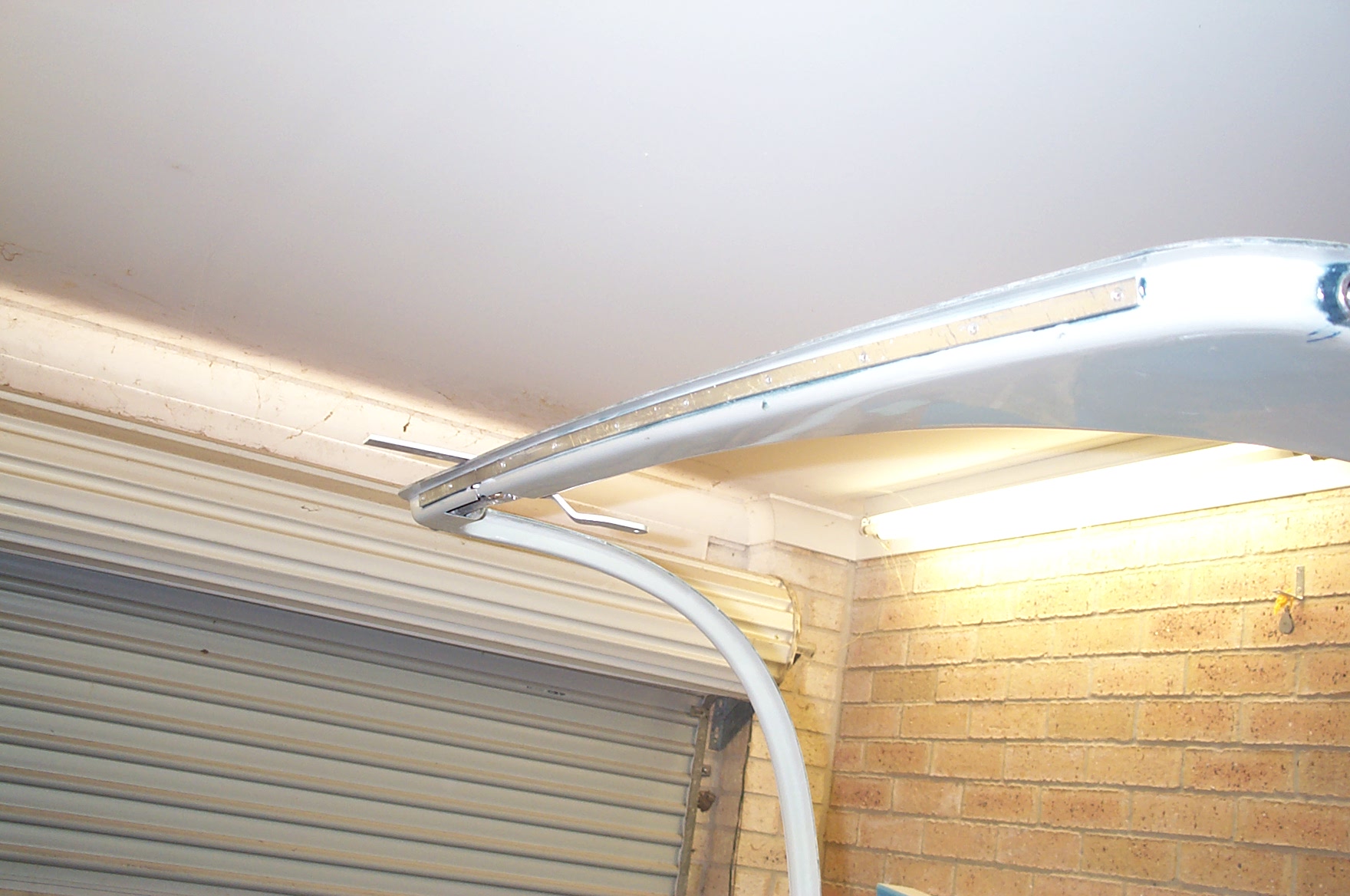

PostPosted: Mon May 12, 2008 5:29 pm    Post subject: Door bulge because of seal Reply with quote
Well here is my fix for the bulging doors, a piece of 3mm x 12mm alluminium
reduxed and flush rivetted, clears the door sill by about 3mm, door was
slightly over flattened with a straight edge and clamps alloy bent to be about
3mm flatter than the curve through the door opening. doors are now even and flush
right along the opening with seals in place. Overall weight increase 80g per door.
craig

PostPosted: Tue May 13, 2008 12:24 am    Post subject: Door bulge because of seal Reply with quote
Craig
4 or 5 plies of UNI carbon would have worked too
Graham
