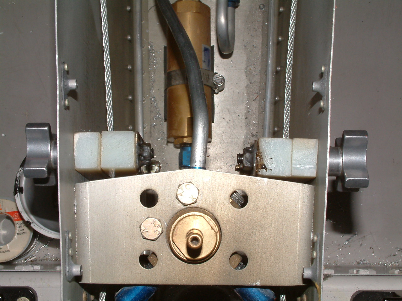

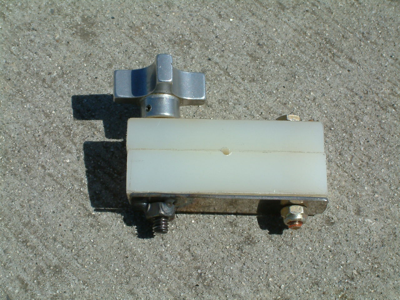

After showing Deems this setup at a great RV-10 NW dinner and flying a while to prove its worth I am ready to go public. I thought of several complex designs using spring bias and scrapped them all due to various reasons.
Lets start with two statements. First, the proper engineering solution is cutting into the rudder and installing a servo and a small trailing tab. This approach has a built-in failsafe in that the rudder pedals can always override the rudder trim. Secondly, I expect my idea to be rejected many in the list because it will be judged as crude, however, a simple design can be elegant in its simplicity.
I chose to not cut into my beautifully painted rudder and opt for a less proper engineering solution. What I have devised is to modify the rudder cable nylon fairleads just in front of the fuel switch valve to also pinch the cable when a screw clamp is tightened. I set the rudder trim with my feet then pinch one or both cables. See attachments for a visual. There are some tricks to get this very simple design to work properly.
The big negative (in my mind) with this approach is I did not want to get caught with the rudder locked when I needed it. The imagined solution was to handle it with procedures kicking the rudder before takeoff and when beginning decent. As I began to fly, this issue became moot since my feet instantly sensed the lock when they are applied to the pedals and my mind learned how to react immediately. My feet feel they are pushing against a brick wall and the release knobs are within inches of my hand. Typically, only one of the knobs are tightened.
Two additional good features were observed. When parked it becomes a great gust lock for the rudder. Also, on my way to the NW RV-10 dinner the yaw ball was centered, my feet were on the floor, and the cable locks were loose when I encountered turbulence as the terrain rose north of Redding CA. We yawed around a bit then I locked both clamps (one per cable). The yawing diminshed about 80% and reduced my piloting effort. In the future, I do not know if I will lock the rudder during turbulence or use my feet. Need more experimentation in this situation.
The original design is pictured in the attachment and I got it about right. After these pics were taken I replaced the Nylox nut with a AN3 anchor nut (AN366F style probably best) to adjust the clamp loose cable tension without removing the tunnel cover. Also, I reduced the outboard nylon block thickness to 3/8" to route the cable around the fuel selector switch. Probably should have been 5/16". The knob is a Reid Supply Co p/n KA-1. Clamp the two nylon blocks together and drill an 1/8" hole through the mating surface. Then mill the thick block with the half hole surface down .015 to .020. This will create a rocking motion with the cable as its fulcrum to create the pinching force.
The pedal force will be heavier than the incredibly light stock version by maybe two times due to the drag of the fairlead. After 3 or 4 flights it is not noticable because the nylon fairlead begins to smooth out and the mind does adapt.

Bill, very simple and crude indeed but it’s a bit refreshing to see a straight forward approach to this problem. Being a very visual person, it’s the first design in a while I could picture in my head just from reading the description of it. I may shamelessly steal this idea. J Do you feel you can “override” the clamping force with a firm push if need be?

Afet to talking to Bill this weekend and seeing the setup, you would bend the tunnel before overriding the clamp...Bill seelmed to think you couldn't do it but I may be speaking out of turn and should wait for him to reply.

I think it is a great idea but I think it has some safety issues that need to be discussed. Being some one who has been just about inverted by clear air turbulence, I don’t like the idea of any flight control being locked in flight. If you have ever had a serious up set in flight it is all you can do to react correctly let alone unlocking a flight control during the upset.
Any one thinking about this mod might want to think about this seriously.

thankyou for sharing your info with us. I am a bit concerned about the safety factor of it being locked in as even the auto pilot can be over ridden with force. I think there are to many "what ifs" for a critical control to be locked in even one side.
I would definitly take it out if you sold the plane.
On our 6 we just riveted a simple bent piece of aloy set up for cruise speed and painted the same as the rudder. Worked fine and failsafe.
Thanks again Bill and I am sure others will have ideas to and will probably disagree with me but thats what the list is for , throwing ideas around.

I wouldn't discard the idea/design too soon. Bill and I also discussed
the 'locking' issue. He's well aware of it. I believe he said that in
his admittedly limited experience flying with it, that he felt that the
ability to 'unlock' the control was so direct and immediate as to make
it less of a risk/concern for him. Additionally, I would expect that
after your plane is tested and rigged the need for variable rudder trim
only occurs during limited portions of the flight. reducing (but NOT
eliminating the risk factor). I suppose it to be similar to the
friction lock on the throttle. Electrically activated trim systems also
have a risk factor associated with runaway.
Now with that said, I'm sure there are those that will still be
uncomfortable with a 'locked' control. There are at least to viable
spring biased designs I've seen, (Al Gardners & Jason Kreidler plus the
'Vic Syracuse solution. I'm only speculating, but _conceptually_ I
believe that it should be possible to work with Bill's design to achieve
a variable clamping force sufficient to hold the desired amount of trim,
and still allow for some 'breakout force' to overcome the friction.
During our discussion Bill mentioned that he had machined/fabricated a
slightly curved surface between the to clamp halves to act in somewhat
of a rocker fashion to enable the clamping action. It may mean
experimenting with some different clamping material, and different
amounts of 'curve'. Another idea would be to incorporate a compression
spring on the end of the other bolt and nut. Some epxerimenting with the
size and strength of the spring would be required, but it would allow
for the clamp to 'float' under variable pressure????????? I've got to
believe that the right combination of materials and camber would allow
for setting enough friction to hold the desired trim and still override
if necessary. Anybody got any suggestions? I also believe that the use
of a finer thread on the control knob may allow for more precise control
of the clamping pressure.

Bill, after seeing this at the NW RV-10 dinner, I'd say it's an interesting idea for a gust lock, but I would recommend against it as a rudder trim mechanism. God forbid you got into an unusual attitude quickly, such as might happen when you have your friendly 757 fly over you as you transit B airspace. I was traveling in a 757 two weekends ago and got rocked, and I mean thank goodness I had my seatbelt on type of rocked, by what I think were wing tip vortices. If I were in an RV at the time, no matter which type, it might have been flipped in seconds. No, I'd want my rudders available at all times.
Just my 2 Pfennig's worth.

There is a certain minimalist elegance to this that frees up the brain
cells a bit. I'm thinking of it as a gust lock for a personal,
experimental aircraft that happens to work quite well as an ad hoc
rudder trim. The '10 does need a gust lock it seems...
We've got a floppy rudder that needs a lock and a trimmer. Hmmmm. I
think I'm going to tear the floorboards out of the Maule and take a look
at it's trim system just for grins.

Many of you folks have the same concern as I have with this implementation. Yet I made this modification to our RV-10 to observe the good and bad things and hopefully design out the bad in the next revision. So far, its worked better than I anticipated and other unforseen good features have arisen. When this happens I get encouraged.
A few comments:
Only one screw needs to be tightened during cruise. The clamp is not used for climbing nor decending.
I carefully choose a strong metal star wheel with deep tangs that fit my fingers to apply force if necessary. The range between tight and loose is approximately 1.5 turns and in a normal cockpit situation I tighten or release it in just under 3 seconds.
I have not determined if the screw can be tightened such that the rudder will not move and still be overridden by the pedals.
I am very interested in Bill Watson's investigation of his Maule, as it has a rudder locking mechanism of some sort.
The RV10 may roll like the RV7 or 8. My guys tell me they routinely perform acrobatics with their feet on the floor so I wonder how much of the rudder would be actually needed with turbulence. I keep my feet on the pedals during turbulence but don't know if I really need the rudder.
Lets use our energy to address the main issue and add pilot override into the design. Revision B could be designed with an automatic slip or limited tension or something else I have not thought of. This is where knowledgable people and good thinking can work.
I will pursue this with or without the Matronics folks. For me, experimental is fun. Thanks for the comments and cares. I am not a wild man and do care about my health, my passengers health and everyone flying.

Bill "door bonding" Watson
Thanks to John Jessen, John Cox, Rob & Jenny Hickman and others for a delightful afternoon. Of course, its always a good day when I see Deems.

Bills_Rudder_Stop.pdf
Download
 Filename:  Bills_Rudder_Stop.pdf
 Filesize:  91.16 KB
 Downloaded:  249 Time(s)
