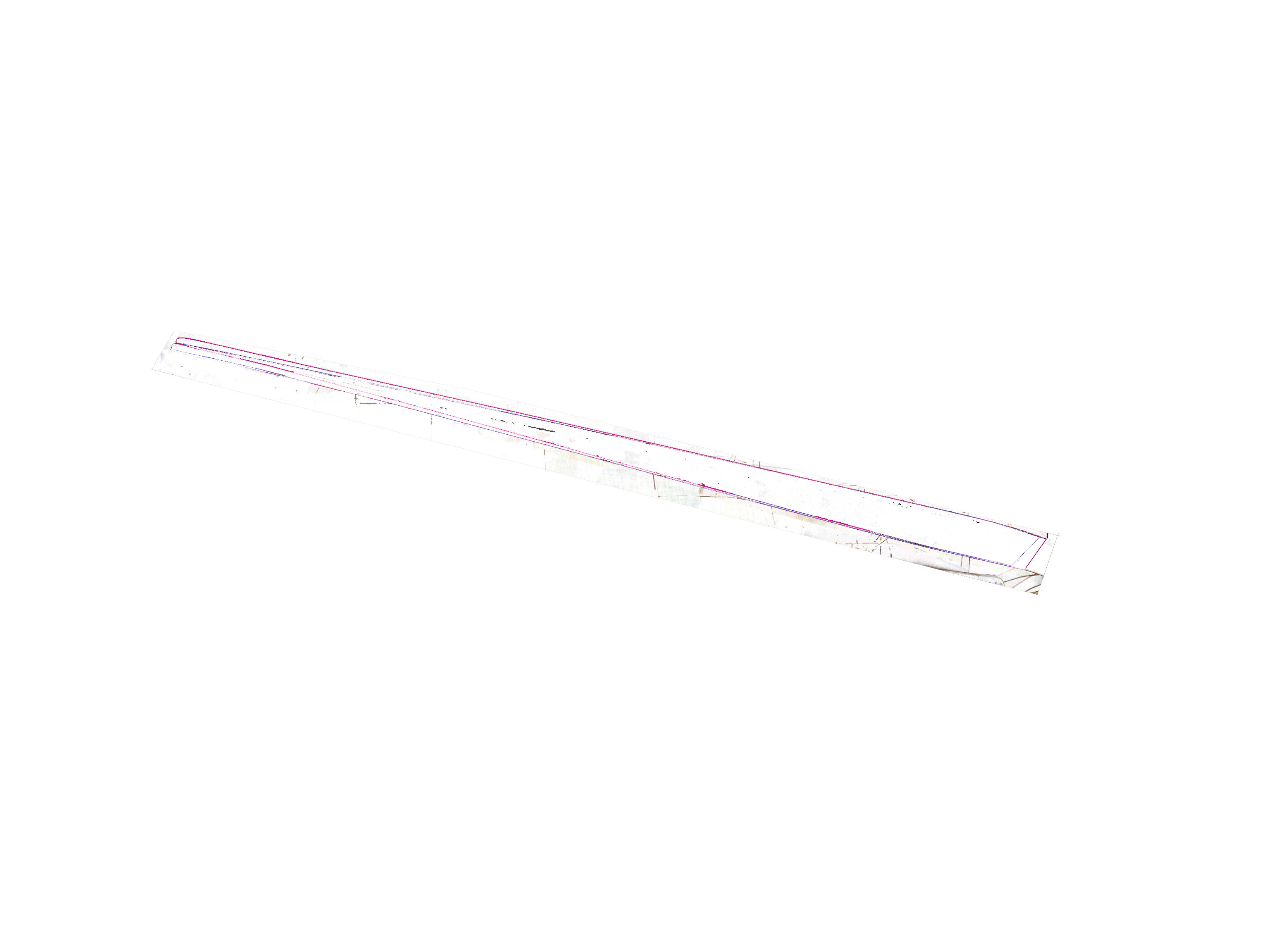

Hours were about 600. However, there has always been a vibration, an annoying feeling its not running sweetly, between 4400 and 5100 revs that has just recently increased to 5300 revs. I have pretty well followed your path trying to track it down, but without a balance have become stuck on that. I suspect my prop, and will try and change it for someone elses soon.
I took three photos from a stationary camera of each blade in the same position then outlined each blade and superimposed them. I don't know if this is a valid way of checking, but it shows one blade is certainly not on track and surprisingly for a lot of its length. Checking the tips for track is not enough perhaps. see attachment.
What is strange, if that is what the problem is, is that at 5400 revs it runs so sweetly. If the prop was the problem is that possible?
The only other clue I have is that checking the mags will give a rough patch very briefly as the revs drop, which I think could be in the float of the bearings of the gearbox. This engine was completely opened up when the sprag clutch broke, 100 hours ago.

Typically the vibration and the range of rpm with that vibration is what you feel if you have a bad pneumatic carb balance. Even if you have done it in the last 25 hrs. do it again. I believe that will help. Don't forget the mechanical balance first and be precise with both.

Cheers Roger. I keep doing them, but I take your point. Be precise!

In answer to your question about vibration smoothing out at 5400 rpm, yes, it is possible. As the centrifugal forces increase with increasing rpm, the apparent out-of-trackness at places other than the tip could disappear. Do you know which blade is running out of track? You might consider removing the blades and comparing them to each other on a true flat surface in several directions. If one of them is measurably out of synch with the others that could be your problem and a blade replacement might resolve the issue.

I do know which prop is out, but may get a chance to swap props this weekend.
Is it feasable to get one blade, or are all three nessessary for a match.
