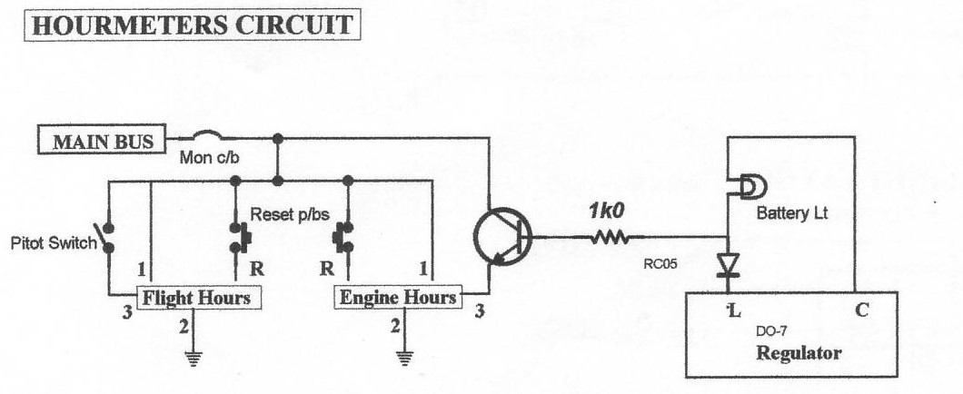

nwcmc(at)tiscali.co.uk
PostPosted: Tue May 06, 2008 6:34 am    Post subject: Switch for Hobbs. Reply with quote
Attached is the circuit I used.
Nigel Charles
