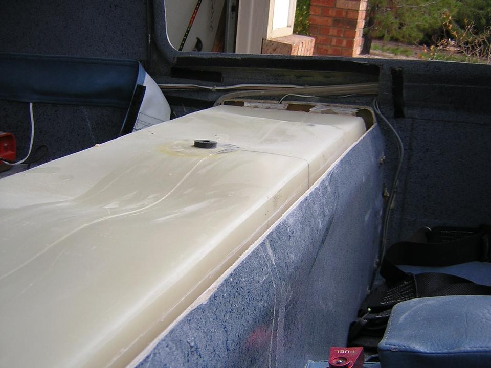

I attached a pic of Steve Hagars top of tank, if you had 3 BID on top of
tank when it was flat, not that you would want to do such a thing, but if
you did, I don't think it would cause cracks to occur. On the other hand
the tunnel layup and the lay ups on the aft base of the tank are all that
is supporting the majority of the weight of the tank. If I didn't already
have CPM bonded in, I would 3 taper BID the base supports as well. I think
the foam will take a real load off all 3 by not allowing the tank to
cantelever as compared to not having foam.

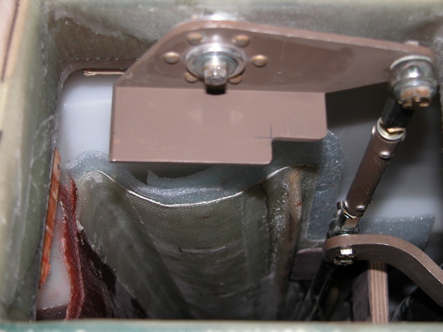

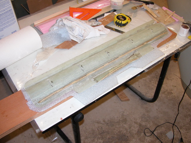

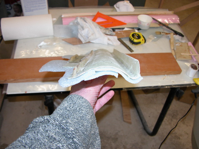

I've already added a vertical separator of sorts which would allow some
bulging of the tank forward face but would prevent such bulging from
interfering w/ the spars and spar strap. It consists of a 3 bid layup
w/ 1/4" x 1/2" balsa stiffeners w/ 2 bid layup and a top flange which
is floxed to the underside of the "shelf" support; it extends down to
between the 2 FG spacers. I hot glued some 1/8" poly foam as a
cushion...pix below.
I'm still curious as to what our tanks are made of...LDPE or HDPE...(?)
Fred
