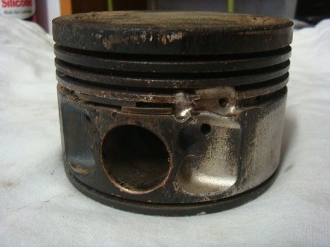

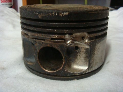

The picture above is of #3 piston removed my engine with 438 hours fresh purchased from Aerostar. I got a chip light and found lots of metal in the 10 micron filter. You can see that either a scraper or compression ring was put in the oil groove instead of an oil ring. The ring was broken in about 4 or 5 pieces. A compression test found the cylinder.   You can see where the ends of the ring jammed over each end. Note too how the lands have broken down. This same engine now has 1300 plus hours with #3 cylinder in the mid 70's. This piston sits in a prominent spot on my hangar desk. NO I don't use as an ash tray.
