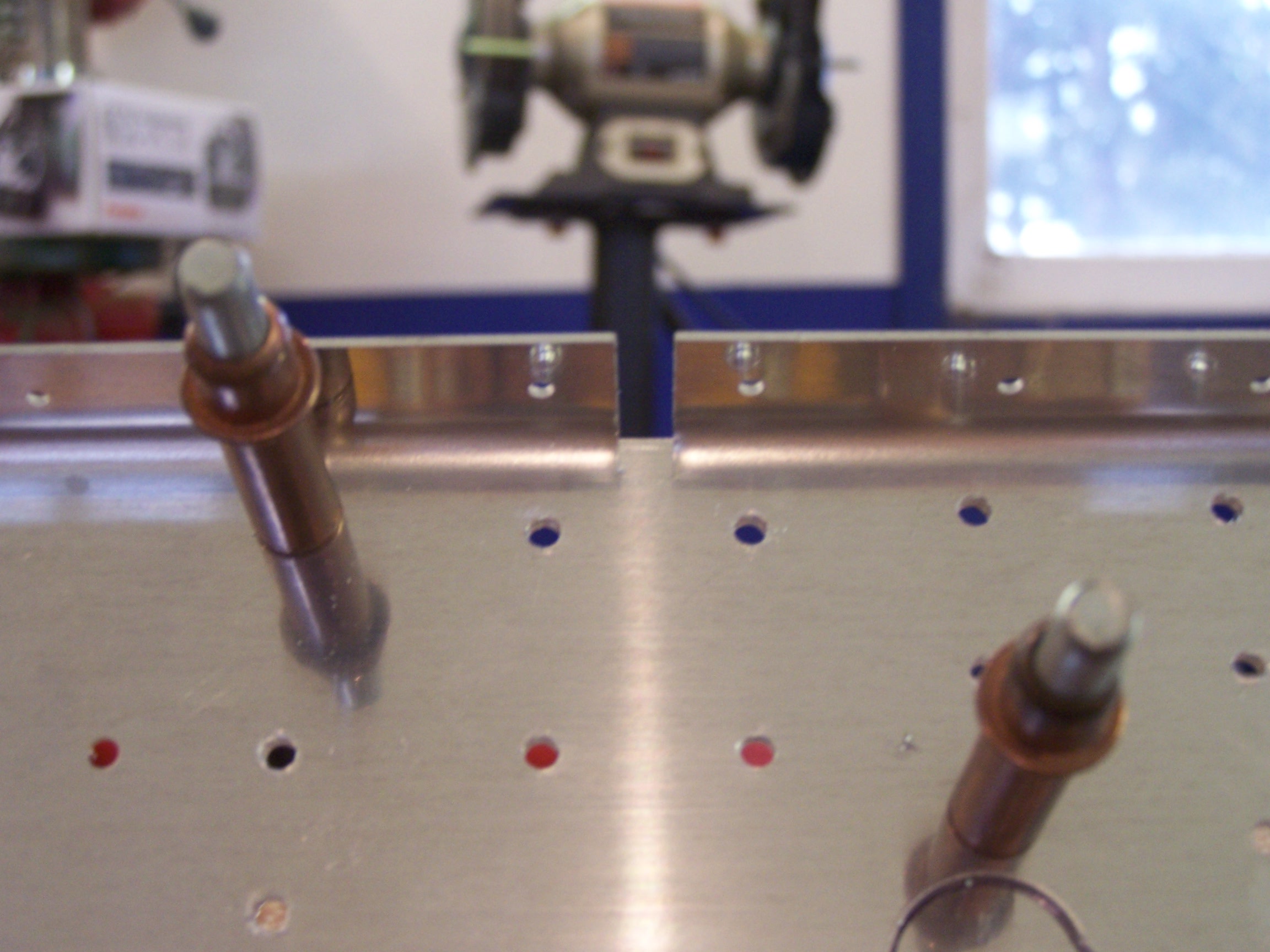

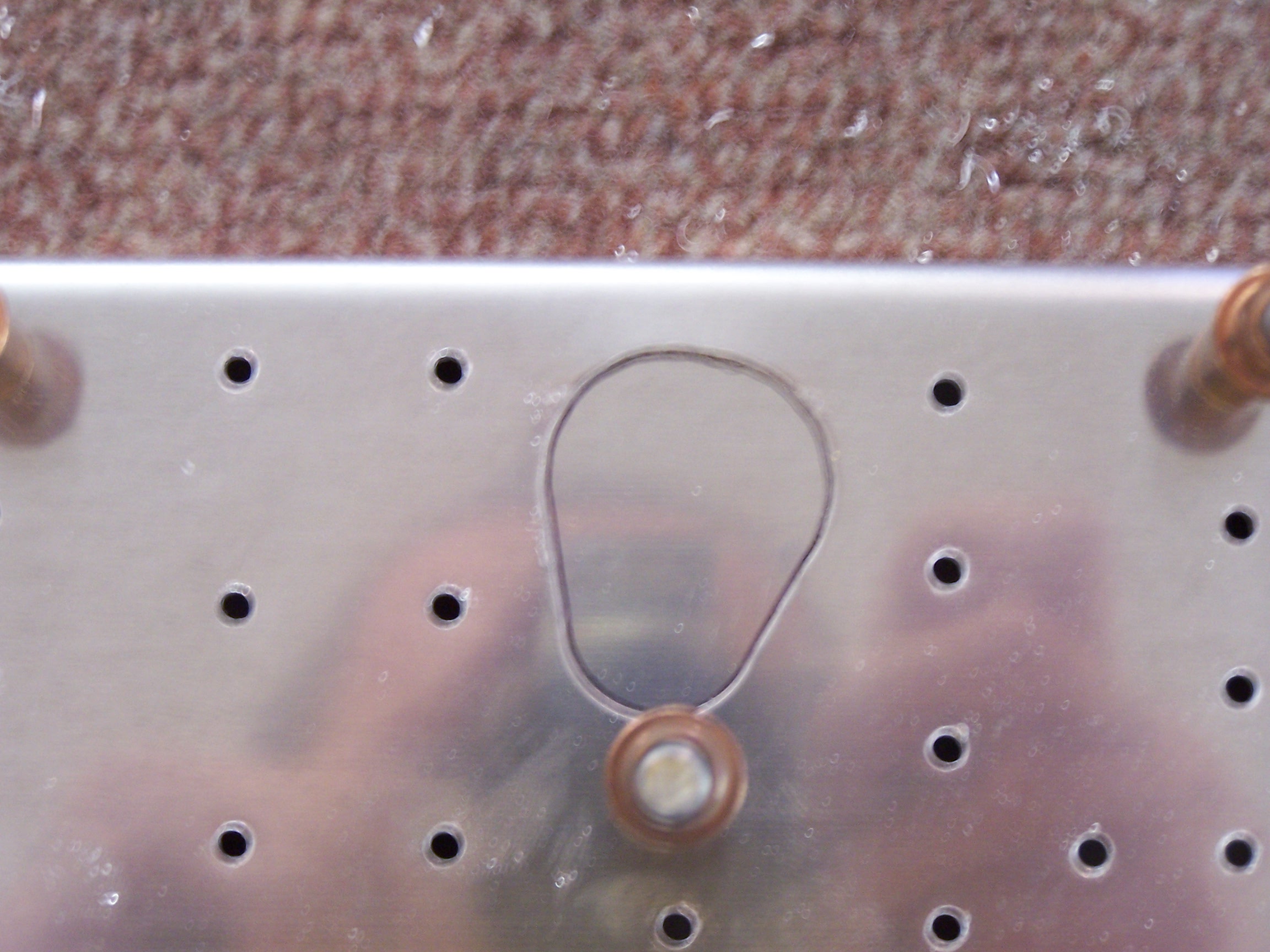

Today I started working on the rear wing spars. The instructions show a "squared" hole to be cut into the W-1007D doubler plate however the hole in my rear spar is actually a "teardrop" shape. Am I to modify the hole in the spar or simply copy the shape in the spar? A picture is attached.
Also, the doubler plates overhang the slot cut into the spar (slot is for the flap brackets I assume) just a little. Do I need to trim the doubler plates to the slot in the spar?? Another picture is attached.

Just off of memory. The teardrop is an improvement so the rivet from the aileron connecting rod can not get caught. Match the holes…..just my old memory at work. If you check the archives I think you can find some discussion on the interference problem.

That is the shape of the hole in my quick build wings.
I will send you a photo off list.
