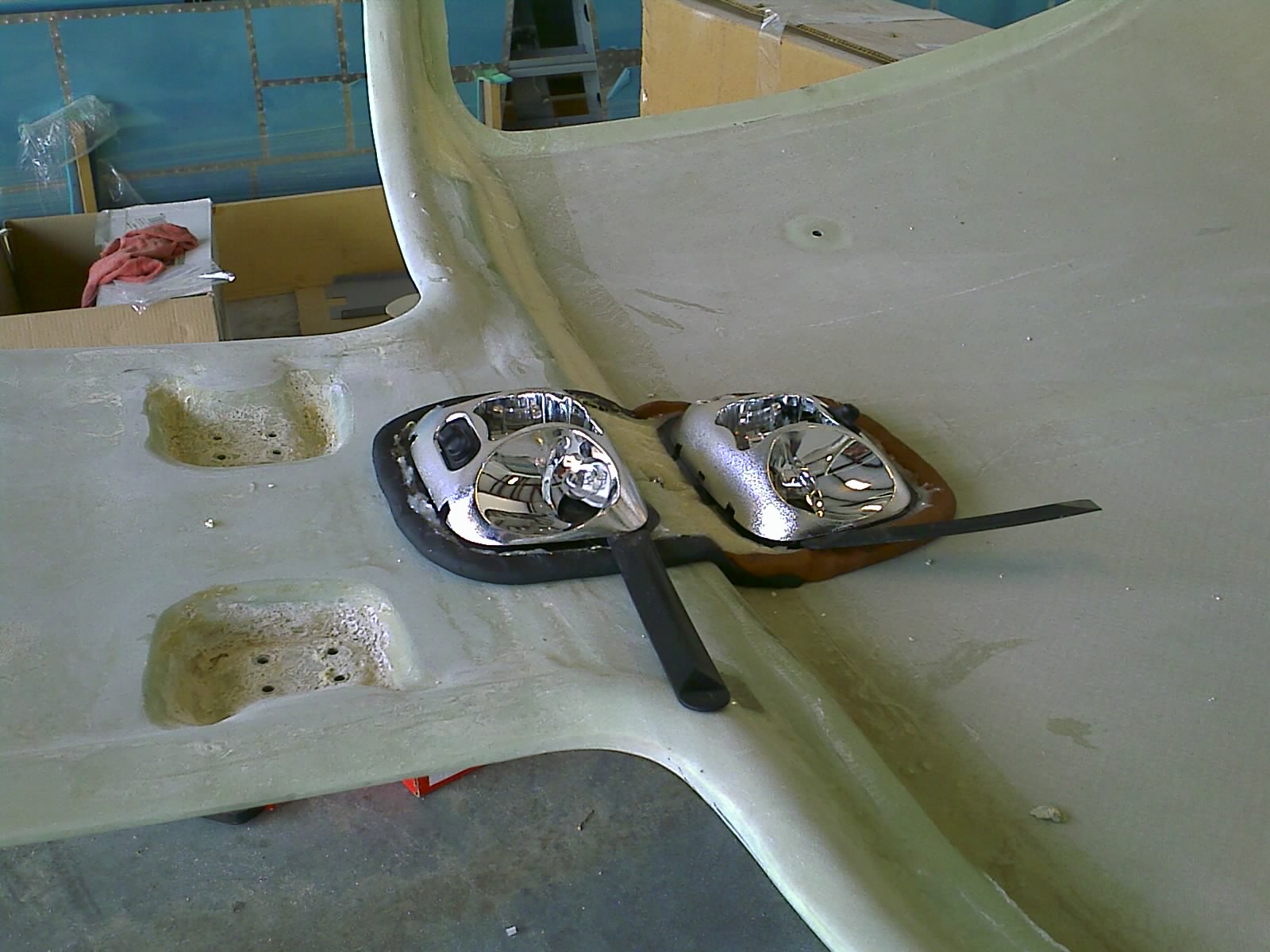

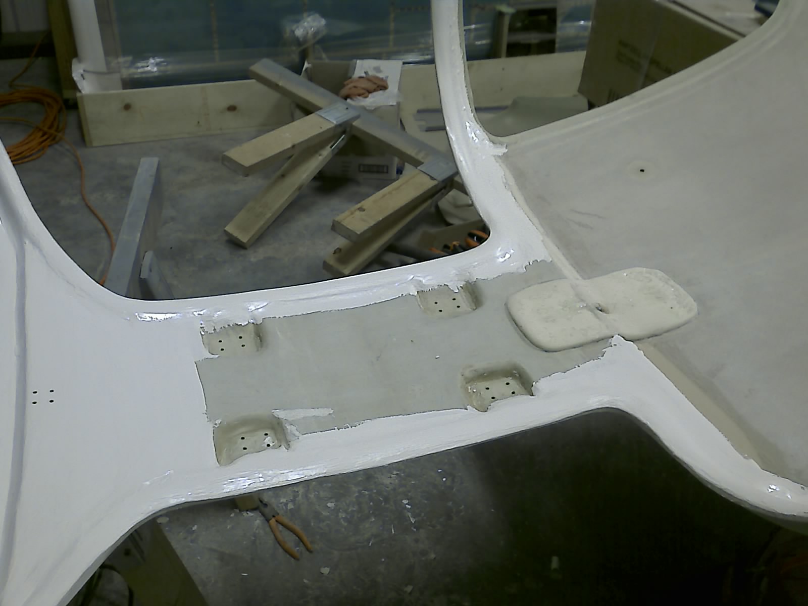

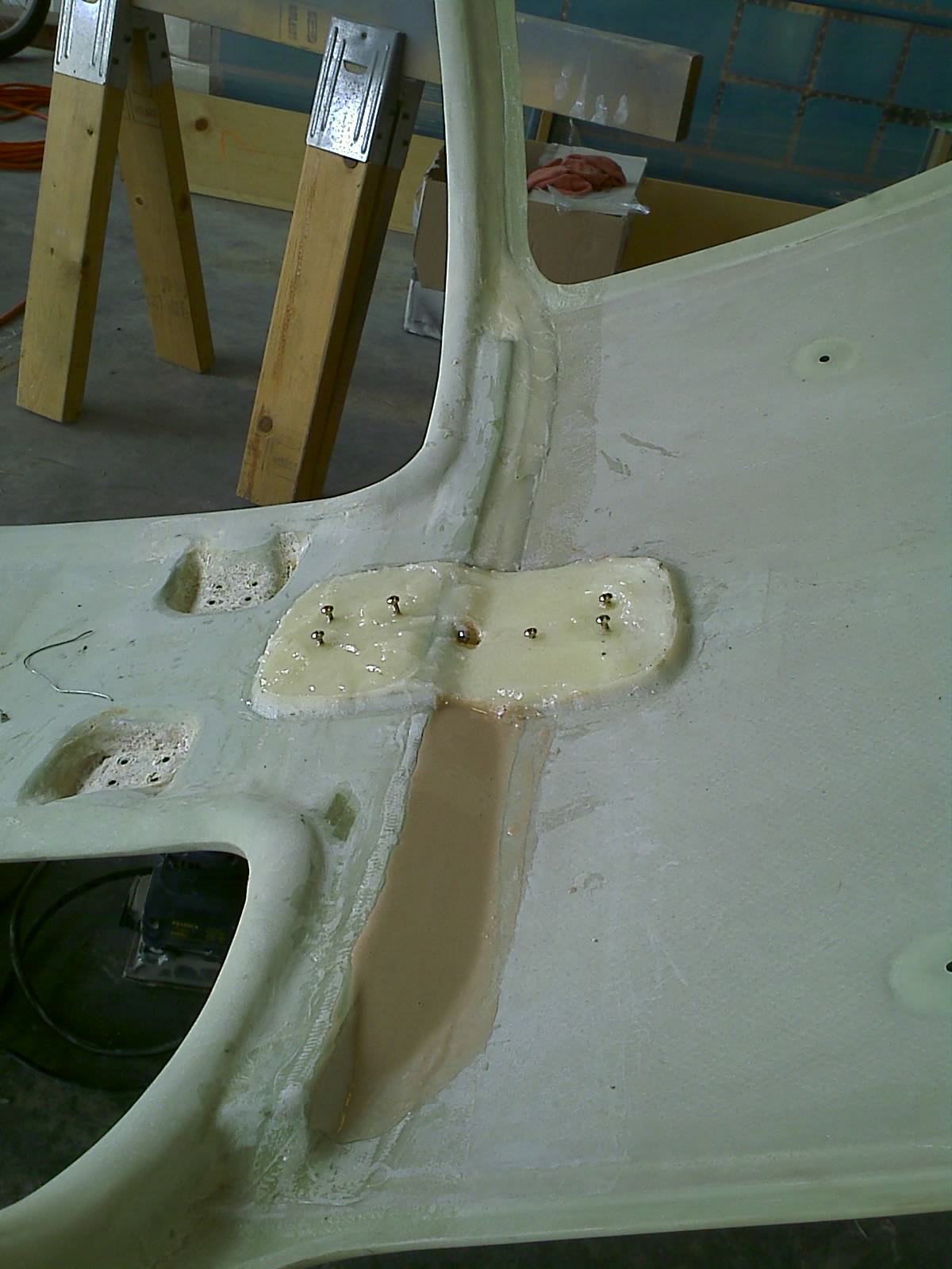

PostPosted: Fri May 02, 2008 6:16 pm    Post subject: Overhead Console? Reply with quote
I went a route that may have been more time consuming but should take up as much room.
Epoxied some 1/4" tubing into place and made a smooth transition from the rear half to the front half of the canopy using West System and colloidal silica. Will run wires through this. Made a "dummy" transition on other side of canopy with fairing filler so that both sides of canopy will have a smooth "ramp" under the headliner. Scuffed and built up the center area, made a fillet around the perimeter, and epoxied nuts into place for attachment screws.
Then dremeled out contours for the bottom of the reflectors as well as wire runs.
The units themselves are standard Ford Ranger courtesy lamps. One reading light on each side, dome light in the middle.
