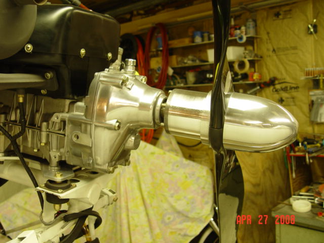

I had some shaking/vibrating ( wings off ) when I started my plane
last weekend...
I'm running two blades on my IVO...Last year it seemed to run
just fine...
Didn't like the shaking/vibration , so I ordered the Balance Master
for Props....( Mercury inside )
Anybody using it..... Like it...?
I asked them if I'm not satisfied will they take it back...
They said 100 day money back ....
Gotta Fly...
