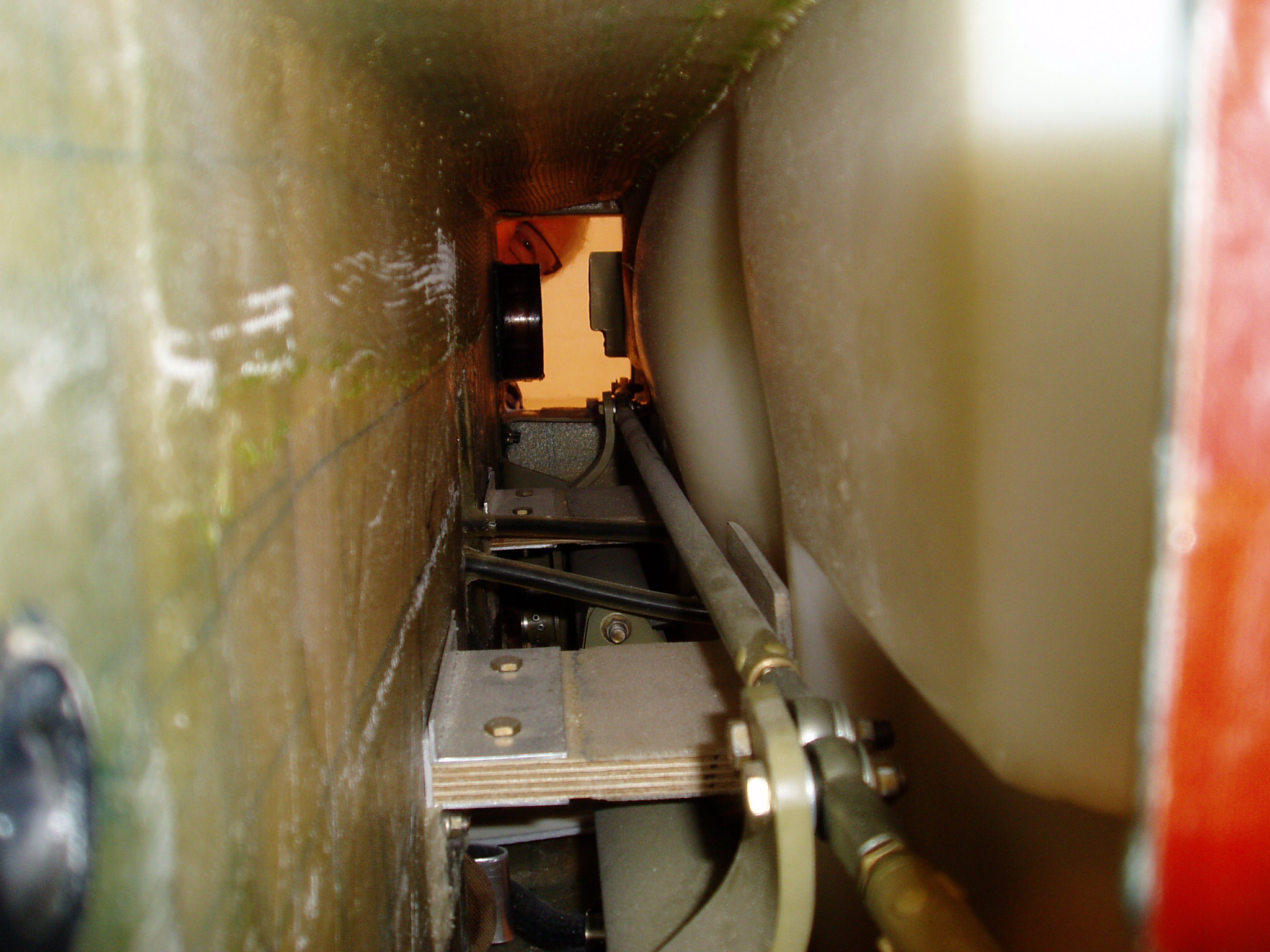

Hi,
Shortly before start of taxiing, it was discovered that fuel was coming out of the fuselage on my Europa XS trigear (LN-ABM), through the access holes below the tank. Draining of the tank was started and the leakage stopped when 20 - 25 litres were remaining in the tank.
Two days before I had drained the tank completely since the aircraft had been stationary (in a heated hangar) since 1. july 2006 with app. 35 litres of mogas in the tank. The day of start up I filled 18 litres and checked all hose connections. Started the engine and runned it for 5 minutes to check hose connections to the recently installed oil thermostat. Then filled another 36 litres of mogas and started the engine for the local flight.
Removing the wings, it was revealed that the tank front facing the wing spars, had great bulges, bulges inwards and outwards, and the centre one touching the aileron cross tube, see attached picture. I have not yet localized the crack, but I suspect the saddle section just ahead of the fibreglass bracket. To me the in and out shape of the bulges indicate compression stresses due to material expansion (caused by the fuel applied, 95 octane mogas?). And I think the crack is caused by shear stresses just forward of the bracket mentioned.
I will appreciate comments and advice. At present I do not trust the material, polyethylene, used in the tank. Has anybody applied metal tanks?

How old is your tank and how long have you had fuel in it? I had to replace mine - it was my fault in the sense that I pressure tested it with too much air pressure and ended up with stress cracks on the outer edges where the wing comes in - but the real problem seems to be it is not a very flexible material and over time I am afraid I will need to replace it again - if I do I guess I will get an aluminium tank welded up - pictures of land Rovers running over the tank may not be the best approach to judging the long term ability of the tank to accept stress -

Arnold;
A143 has been down for awhile while I am developing an aluminum tank for it.  I got
the leaks after draining gasoline from the tank.  What happens is that the tank
expands and I am told that if it is drained it shrinks back slightly.  My crack
developed right alonside one of the layup straps in the saddle area.  Get a small
mechanics mirror and start probing around.  The bulges you are seeing in the spar
aperature are only an example  of what happens  to all of the surfaces of the tank.
When I cut my tank out of the cockpit seatback the top of the tank was all rippled
where it had expanded and was constrained by the top of the seat back.  The back flat
surface also exhibited  thesame phenomenon it was just constrained by the cockpit
section.

Hi Everyone
As you may know from previous posts. I had a tank split on me last year after bringing my aircraft over to the USA from UK. The aircraft had been used for several years in UK without problem. The tank had sat empty for over two months before being refilled with unleaded fuel again (thanks to US customs). The split occurred on the inside of the tunnel and was very difficult to see even with the wings removed. Initially we tried to repair the damage by cutting off the top of the tank applying a sealant to the inside and refitting the top, which seemed easier than removing the whole thing. The repair lasted about a week and then started to leak again! So the only solution was to remove the tank and replace it. The reason I tell this story again is to hopefully avoid anyone else either leaving the tank empty after it having previously been filled with fuel (I am convinced that was the cause of the split) or trying to effect a repair. The only solution in my opinion is to simply cut it out and replace the thing. The bulges seem to appear after a time on almost every Europa I have seen so I wouldn’t be too concerned about that
Hope that helps.

"Troubling" is the kindest word I can utter on this topic.
Heretofore I have eased my mind with the notions that fuel tank
failures have been the result of previously-filled tanks left empty for
extended periods and subject to abnormally high ambient temperatures
(say, an Arizona summer).
Now it appears in Arnold Hansen's case that a partially filled
tank...left untouched for 20 months (with no leaks) but not subject to
extreme temp. changes...then drained for two days and partially
re-filled...is subject to failure.
And Jeff B has been flying the pants off of Baby Blue and finds bulges
and distortion in tank shape sufficient to contact control rods.
Sounds to me that we have a very serious issue on our hands.
I have CM installed, top just clecoed, and will be checking on the
feasibility of supplementing the plywood and aluminum angle
spacers...with the intent of minimizing tank bulging and preventing
interference w/ the control rods. I reason that maintaining the shape
of the tank as much as possible should reduce crack-inducing stresses.
Fred

PostPosted: Wed Apr 30, 2008 11:02 am    Post subject: Fuel tank - bulges and leakage. Reply with quote
Fred and all,
That would be my approach, if I were to build again. Support the front
of the tank with ply, or some such and possibly spray foam all other
areas, to add support. Seems this would completely encase the tank and
keep it relatively ridged. Any other ideas?

PostPosted: Wed Apr 30, 2008 12:48 pm    Post subject: Fuel tank - bulges and leakage. Reply with quote
All,
Preventing the tank from bulging too much forward will of course prevent it
touching any of the controls or the wing spar (in which case the strap on
the left spar might catch on the bulge during withdrawal/installation).
The inherent problem with high density polyetylene (HDPE) without any
barrier layer (which automobile tanks have, and the newer Europa tanks may
have - this is now being looked into) is that it is permeable and components
of the fuel get into the material and causes it to swell (and some gets
through the tak walls and gives the typical "Europa smell"). Where the
material is thick, as in the edges between the bottom and sides, sides and
top, and sides to sides, the swelling is apparently negligible. This
swelling cannot be stopped as such, so if the tank is prevented from
buckling forward at all, it will bulge only inwards. This will probably not
be one single large bulge in each panel, but smaller "wrinkles" that another
contributor reported yesterday from his findings along the top and the back
(where outward bulging is restricted).
The best, given this undesired but unavoidable swelling, would be if the
tank were of a simpler shape (say like a box without indentations and the
saddle) and if we had no spacers to keep it away from the controls. Typical
hard points as the saddle and the outlets at the bottom appears to be where
cracks are developing in some cases. Even though the fuel components
entering the permeable material also acts like softeners, local faults in
the material may cause overstressing (e.g. thinner than intended material
due to the fabrication process; maybe insufficient heating during the
moulding).
The spacers installed according to the Builders Manual could be typical
danger areas as far as cracks. However, both on Arnold's tank and mine
(which shows far less bulging - yet), the wave form of the bulging across
the width of the tank is such that there is an inward bulge right behind the
spacers and a forward bulge on either side. It is easy to envisage the
stress that would be introuced if a spacer were installed where the tank
naturally wants to bulge forward.
So, based on what I have observed and learned about the tank material in
these last few days, I would carefully evaluate where to stop the tank's
bulging. Newer tanks have a stiff rib or indentation running across the
front, which should help (one such installation will be inspected shortly by
another owner).
As for those still in the appropriate build stage, I would shape the BM
spacers differently: Build the plate of thicker material, oval instead of
rectangular (with long axis horizontal) and shape its thickness markedly
convex (thich in the center, thinning towards a well rounded circumference).
I am in contact with a polymer expert at a central Norwegian scientific
institute. His immediate comment is that HDPE does not "dry out" if the
tank is left empty, but I am awaiting his further comments to a host of
follow-up questions with relevance to our particular tanks and how we
operate our airplanes. Temperature definitely plays a part in the swelling.
The hotter, the faster it swells, but I am still awaiting to hear from him
whether HDPE swell more (higher maximum swell elongation) in hot weather
than in cold. He also mentioned that the particular fuel used may play a
role. When a major fuel supplier here introduced unleaded 98 octane mogas
several years ago, it was found to "attack" polymers more aggressively than
the previously used auto fuel did (we use unleaded 95 octane mogas in our
Europas here in Norway).
What I really hate about this issue is not knowing whether I have spent 10%
or 90% of my tank's safety margin with the present bulging, and what does
say 5mm more bulging translate into as far as approaching a crack somewhere?
Svein
LN-SKJ

PostPosted: Wed Apr 30, 2008 1:08 pm    Post subject: Fuel tank - bulges and leakage. Reply with quote
So, what you're saying is that the tank "grows" as it swells and will do
so inwardly if not allowed to, outwardly. Hmmmm, that's something I
hadn't considered. I'll have to rethink my solution. Thanks for the
information, Svein. Please keep us up to speed on any additional
information you should get...
Jeff - Baby Blue
Sidsel & Svein Johnsen wrote:
<sidsel.svein(at)oslo.online.no>
All,
it touching any of the controls or the wing spar (in which case the
strap on the left spar might catch on the bulge during
may have - this is now being looked into) is that it is permeable and
components of the fuel get into the material and causes it to swell (and
some gets through the tak walls and gives the typical "Europa smell").
Where the material is thick, as in the edges between the bottom and
sides, sides and top, and sides to sides, the swelling is apparently
negligible. This swelling cannot be stopped as such, so if the tank is
prevented from buckling forward at all, it will bulge only inwards.
This will probably not be one single large bulge in each panel, but
smaller "wrinkles" that another contributor reported yesterday from his
findings along the top and the back (where outward bulging is restricted).
the saddle) and if we had no spacers to keep it away from the controls.
Typical hard points as the saddle and the outlets at the bottom appears
to be where cracks are developing in some cases. Even though the fuel
components entering the permeable material also acts like softeners,
local faults in the material may cause overstressing (e.g. thinner than
intended material due to the fabrication process; maybe insufficient
heating during the moulding).
across the width of the tank is such that there is an inward bulge right
behind the spacers and a forward bulge on either side. It is easy to
envisage the stress that would be introuced if a spacer were installed
where the tank naturally wants to bulge forward.
shortly by another owner).
of rectangular (with long axis horizontal) and shape its thickness
markedly convex (thich in the center, thinning towards a well rounded
circumference).
swelling. The hotter, the faster it swells, but I am still awaiting to
hear from him whether HDPE swell more (higher maximum swell elongation)
in hot weather than in cold. He also mentioned that the particular fuel
used may play a role. When a major fuel supplier here introduced
unleaded 98 octane mogas several years ago, it was found to "attack"
polymers more aggressively than the previously used auto fuel did (we
use unleaded 95 octane mogas in our Europas here in Norway).
10% or 90% of my tank's safety margin with the present bulging, and what
does say 5mm more bulging translate into as far as approaching a crack
somewhere?
Svein
LN-SKJ

PostPosted: Wed Apr 30, 2008 2:48 pm    Post subject: Fuel tank - bulges and leakage. Reply with quote
I tend to blame the oil companies for putting all sorts of stuff in the
fuel without a word to anyone.
Could be wrong I suppose
Graham
Heretofore I have eased my mind with the notions that fuel tank failures
have been the result of previously-filled tanks left empty for extended
periods and subject to abnormally high ambient temperatures (say, an
Arizona summer).
interference w/ the control rods. I reason that maintaining the shape of
Fred
Graham Singleton
Tel: +441629820187
Mob: +447739582005

PostPosted: Wed Apr 30, 2008 3:41 pm    Post subject: Fuel tank - bulges and leakage. Reply with quote
When I inspected my tank a couple of years ago I noticed that the back wall had buckled inward, probably reducing its capacity somewhat. This may well have happened on other Europas, but unless you have a large opening at the top you would never see it. I have an opening for the fuel level probe,
which allows me to get my whole arm into the tank. I was considering constructing some sort of internal framing, but couldn't come up with a good solution.
Karl

rparigor(at)suffolk.lib.n
PostPosted: Wed Apr 30, 2008 5:14 pm    Post subject: Fuel tank - bulges and leakage. Reply with quote
If anyone is interested, here is what we did to "Say "NO" to Crack (in
fuel tank)":
http://www.europaowners.org/modules.php?set_albumName=album233&op=modload&name=gallery&file=index&include=view_album.php
Our CPM was in but top was off, but with a little effort you could drop
the pushrod and do layup of tunnel from rear. Use plastic and BID, easy to
polk BID flat from bottom of aeroplane, 2 person job though. Foam very
dooable on completed plane.
Ron Parigoris

PostPosted: Wed Apr 30, 2008 6:54 pm    Post subject: Fuel tank - bulges and leakage. Reply with quote
Thanks for that Bob.
So is the problem of cracks and bulges limited to the use of mogas? Has
anyone using Avgas had bulges or cracks in the tank? For those of us who
have not yet had fuel in the tank, would avgas be better?
Keith Hickling,
New Zealand.
fklein(at)orcasonline.com
PostPosted: Wed Apr 30, 2008 7:22 pm    Post subject: Fuel tank - bulges and leakage. Reply with quote
On Wednesday, Apr 30, 2008, at 13:46 US/Pacific, Sidsel & Svein Johnsen
All,
prevent it touching any of the controls or the wing spar (in which
case the strap on the left spar might catch on the bulge during
Before getting Svein's thoughtful and informative post (thank you
Svein!), I spent some time looking for a solution to potential bulging
in my tank (which came w/ kit # A194, shipped from the factory in fall,
2000).
In order to "contain" the (outward) bulging, I reset my spacers (which
have generous curves at the corners of the specified lay up) to ensure
a gap between tank (dry and never filled w/ anything) of between 1/8"
and 1/4" and maintaining 1/4" clearance from the aileron control rod, I
was planning to do the following:
Insert a piece of 1/8" thick plywood, 6.25" x 34", w/ 1 layer of bid
each side between the spacers and the front face of the tank,
cushioning the plywood w/ 1/8" thick "sill sealer" (I believe it is a
closed cell polypropylene foam available in 6" rolls at any building
supply) between the plywood and the forward face of the tank. Prior to
insertion, I would add a 3/4" x 2" x 34" foam stiffener w/ 2 layers bid
on the forward face of the plywood. The plywood would be held in place
w/ a 2 ply bid 2" wide tape which laps onto the underside of the FG
"shelf" (previously installed as per manual). In doing this, my goal
would be to resist "bulging" of the forward face of the tank.
Having reviewed Svein's post, I will not be doing anything until we
have more information, hopefully in answer to Svein's questions on the
nature of the HDPE used in our tanks.
I do appreciate so much the value of this forum as we attempt to
address this insidious problem.

PostPosted: Wed Apr 30, 2008 9:22 pm    Post subject: Fuel tank - bulges and leakage. Reply with quote
I'm rather concerned about this too. Going to have a look at my tank
for signs of bulging.
Almost certain I'm converting the mono to a conventional through Bob
Berube. Just need to price it out.
Do you know if the tank can be replaced easily?
This forum is invaluable!
