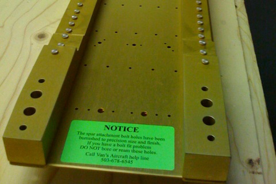

craig(at)craigandjean.com Guest
Posted: Sat Apr 26, 2008 11:27 am Post subject: New Project Problems |
| Quote: | Zenith told me that it isn't as much the bolt hole tolerance that is critical but the clamping pressure of the bolt that is more important just like the prop.
They told me the same thing. But it is at odds with the requirement that the holes be precision reamed. On an RV-7 the equivalent holes are burnished. I’ve attached a close-up of a shot of Lance Gingell’s RV-7a spar. He is making great progress: http://lancegingell.blogspot.com/
BTW: the only way I have found to get an accurate measurement on the hole sizes is to use plug gauges. I bought a set from Grizzly but Zenith has been loaning a handful of gauges near the correct size to other builders to check theirs.
-- Craig

n801bh(at)netzero.com Guest
Posted: Sat Apr 26, 2008 4:34 pm Post subject: New Project Problems |
The forces acting on that joint are in shear, not tension. A reamed hole is critical. Period!!!!
