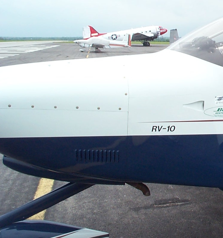

PostPosted: Mon Apr 28, 2008 5:34 am    Post subject: RV10-List: Reply with quote
Is everyone using the bottom cowling vents? This might aid in air
circulation on the ground leading to somewhat better cooling? I have no
idea what I'm talking about, but might be another data point.
John Jessen
jim(at)CombsFive.Com
PostPosted: Mon Apr 28, 2008 2:54 pm    Post subject: RV10-List: Reply with quote
Check with Alex De Dominicis. He has them on his RV-10. Engine seemed to run much cooler. He sells the vents.
I was there last week doing some RV-10 training. My first time in an RV-10. I am a low time pilot. Really good for me. I highly recommend the training.
While we were doing pattern work. Someone at the airport asked for a set to be used on a Lancair.
Jim Combs
N312F
(40192)
