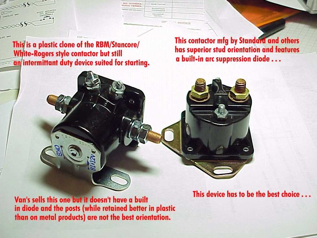

Last time I had any specific information on Van's contactors
he was selling Cole-Hersey battery contactors. I think his
starter contactors were commercial-off-the-shelf devices too.
These are in the same league as the devices offered by B&C.
I'd be interested in hearing from any folks who are having
difficulties with devices from either source.

Also, let me be clear that I did not test the contactors but instead
took the shotgun approach. The battery contactor is in fact a
Cole-Hersey so do not want to mis-represent it's quality.
I replaced the starter contactor as well for good measure Smile
