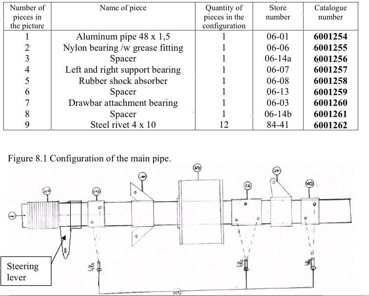

For the first time ever, I had a bit of nose gear shimmy after landing. Our Allegro is the oldest one in the USA so perhaps no one else has yet experienced this. Ours has 565 hours on it. Upon inspecting, I found the "drawbar attachment bearing" allowing a little fore/aft movement. Ours is factory built so I've not had to install or remove this part which is referred to as "store number" 06-03 and "catalogue number" 6001260 in my assembly manual.
My questions:
1) Have you had any nose gear shimmy?
2) If so, was this the cause or was it something else?
3) For those who built their Allegro, what is involved in removing the old one and installing the new part? It looks like removing the fork and the lower "spacer" will allow it to be slid off the nose gear tube.
4) I've asked B Bar D for price and availability but have not hear back from them yet.

When I inspected the nose gear after the shimmy developed the only
place I saw any relative movement was between the drawbar bearing and
the nose gear tube. I"ll inspect more carefully all the drawbar
connection points to confirm there is none there too. I can see how
the drawbar is installed/removed. My question was about removing the
drawbar bearing, not the drawbar itself. Unless I discover relative
motion elsewhere it appears that the sleeve bearing material, which
appears to be made of nylon, Delrin, UHMW or something of the sort,
has worn out. If that is the case, which seems likely, then replacing
that bearing or at least the sleeve material should resolve the problem.

Thom:
Sorry I did not clearly understand your email. I may still not understand
the item in question. Are you talking about the small swivel bearing that is
pressed in the back end of the draw bar, or are you talking about the large
nylon (?) sleeve bushing that is on the front gear aluminum pipe which
attaches to the front end of the draw bar? If it is the small swivel
bearing, I believe it is pressed in the back end piece of the draw bar. If
it is the large nylon (?) bushing, it can easily be replaced.
