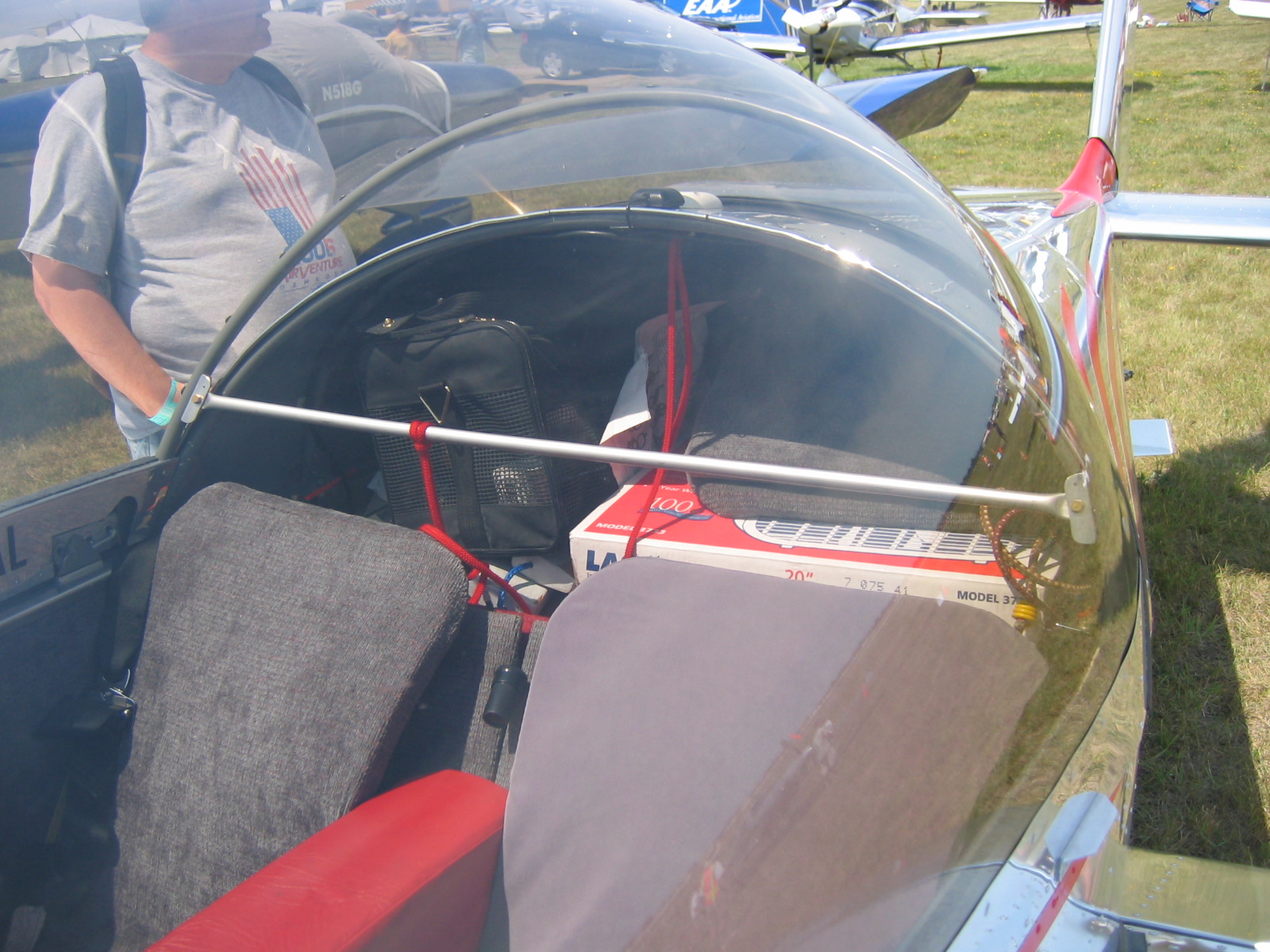

When I flew my AMD601XL check ride a few weeks ago, I noticed two things about the canopy: 1. I was not totally comfortable with latching the canopy and had to do it twice to reassure myself that it was secured. 2. When we opened the canopy upon returning, I almost was not able to grab it quickly enough to prevent it from blowing open due to the windy day.
At Oshkosh last year, there was a customer built 601XL in the Zenith booth that had a modification which caught my eye. This XL had a bar going horizontally across from one side of the aft canopy support hoop to the other at just around shoulder level. The picture I took of it is attached to this post. I guess I can see both positive and negative attributes to this bar. It can give you something to grab to help in both opening and closing the canopy. On the other hand, I see where it could be a ‘head knocker’ or a barrier to being able to reach into the baggage area. Fortunately, in this airplane, it is bolted in and thus easily removable if it turns out to be more of a pain than a help.
I have also seen numerous 601’s with a strap or rope attached at the top of the hoop (Mac’s, for example). This can be an aid in initially pulling it back to close as well as to control the opening on a windy day.
Since I am working on my canopy now, I am interested in this and other intriguing additions to aid with canopy operation. Does anyone out there flying have any thoughts or suggestions on the usefulness of these types of modifications??

Did you ask the owner why the bar was there? Looks to me like it could be used to retain the baggage from flying forward. I would find it hard to use to close the canopy as it looks like it is behind the seats. DO NOT ARCHIVE Jerry of GA

The owner was not there with the plane so I could not ask. I asked Nick Heintz what he thought and all I got for a reply was something like 'unnecessary.'

So am I and let me start with this little hissy fit, "I HATE THE CANOPY."
I love the visibility it provides but it is the single worse designed thing to build in the whole kit. I damn near lost an arm in WW's tail dragger at CC #10 when Gus was about to take me up and just as I was getting seated the canopy started coming down.
I like the idea shown in the pic you posted Dave. One problem it might solve for me is the canopy latches not lining up properly when I close it. Plus it gives you a good place to attach strap from the airframe to the canopy to both stop it from opening too far in wind and to pull it down. The fact that it also acts as an additional stop for stuff in the baggage area from flying into the back of your head is a bonus.
