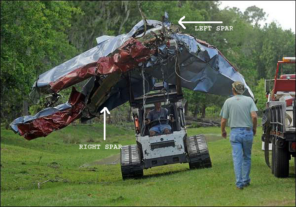

PostPosted: Tue Apr 22, 2008 2:51 pm    Post subject: Re: 601XL Wing Failure 4/7/2008 Reply with quote
"The left wing was bent upward (in the positive direction) at the wing root approximately 90 degrees, with the remainder wrapped around the top of the airplane....Detailed examination of the left wing revealed that the lower main wing spar cap was fractured at the wing root." Quote from NTSB preliminary report.
Not my words, not the words of an "eye witness", and not a bit of speculation on my part.
SOMETHING IS NOT RIGHT!! My 2 cents worth. Go ahead, flame away.
