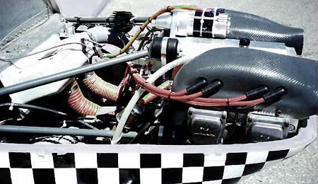

amyvega2005(at)earthlink.
PostPosted: Sun Apr 20, 2008 7:50 am    Post subject: Jab 2200 question Reply with quote
see attached picture of 2200 Jabiru on XL.
Juan
 Filesize:  43.61 KB
 Viewed:  451 Time(s)
